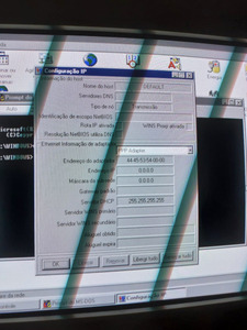

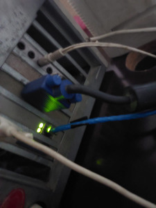

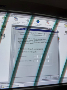

Hey guys, i need a little help here. I have a Windows 95 PC, and i wanted to connect to the internet to use Retrozilla or play some Diablo and Quake on lan, but i am having some problems with that.
is connected from the modem to the computer, am i doing something wrong? and if yes, what i could do to make work?
    143.22 KiB
    1224 views
    210.07 KiB
    1224 views

Assuming this "modem" is also a NAT router (do not ever plug a retro system directly into a non-NAT modem where it might get a public IP), does it work if you plug in a modern computer instead?
Windows 95 supports DHCP, TCP/IP, etc, so... I'd like to think it should be able to get an IP if there's a DHCP server running on this "modem"

To help you recognize the type of modem you have, you can count the Ethernet ports.
If there is 4 or 6 or 8… then it's probably a modem router. If there's one, then It's probably an older PPPoE modem.

As for winipcfg, the box with the "PPP Adapter" is a dropdown. Select your network card there and check if it got its IP address.

it does not have, for some reason, maybe my network adapter is broken?

Can you get a picture of your ethernet card? It's weird that Win95 is calling it "Driver Ndis2 existente"... did you upgrade from WfW 3.11 or something? Why is it calling at an NDIS2 (old) rather than specific model of the card.
