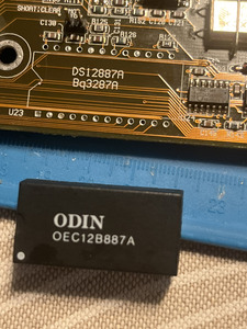

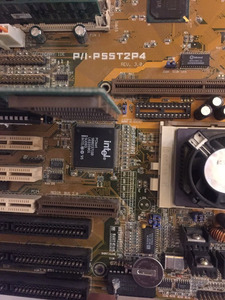

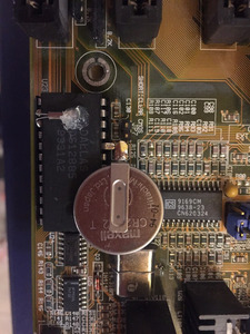

My P/I-P55T2P4 has a dead RTC.
It’s a ODIN OEC12B887A.
After hours of de-soldering I finally managed to remove it.
I had ordered a necroware nwX287 on eBay, but just saw I ordered the one with bq4285S so it’s the wrong one 😒
I’ve now ordered one with bq3287 instead which according to what I’ve read should be the correct one.
BUT
The the PINs on my original ODIN doesn’t seem to be the same as the necroware bq3287 model according to necroware GitHub: https://github.com/necroware/nwX287
Perhaps that is not an issue and I should solder all of the pins that the nwX287 has.
Is that correct?
I’ve added some pictures of the ODIN, PIN number one is the top right one on the last picture. So 2,3,16,20,22 is “removed”. This doesn’t match up with the necroware which states the following pins should not be used: 2,3,16,20,21,22.
Should i simply go with what the necroware GitHub states and don’t use PIN 21?

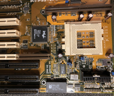

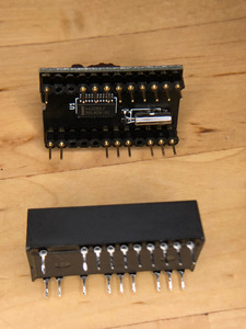

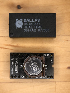

I'm newbie like you, so I don't have answers to any of your questions. What I do happen to have is the exact same motherboard with a dead RTC and a necroware replacement that I haven't got around to doing yet. So, I'll just do it.
Mine has a Dallas DS12B887:
1.91 MiB
818 views

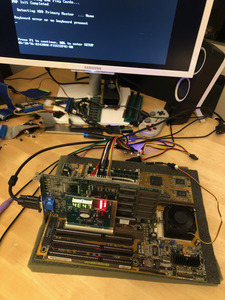

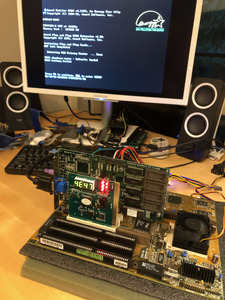

I've learned this lesson the hard way, so booting it up first to make sure it works:
1.06 MiB
818 views
All good. 👍 Can see the (blurry) CMOS battery failed error.
All right, what do we got:
764.38 KiB
818 views
594.88 KiB
818 views
Looks good to me!
1.07 MiB
818 views
This is mine third time soldering anything, so I'd say it's a pretty good little job for a newbie. Btw since you're worried about pins, you should know that I put a socket into the motherboard first, and I certainly didn't snip any pins on it.
Reply 3 of 12, by jmarsh
nizce wrote on 2023-10-30, 21:43:
It should be fine.
Pin 21 is the RCLR# pin, used to wipe the CMOS info stored in the chip. On motherboards that supported this function there is a CLEAR CMOS jumper that connects this pin to ground. But gradually it stopped being supported and the DS12887A got rid of the pin.
All it means is that the CLEAR CMOS jumper on your board (if it has one) won't work with the necroware chip, but otherwise it will function the same as the ODIN.
(Are ODIN chips even sealed with epoxy? I know some of the other non-Dallas RTCs you can just pop the cover off and get access to the battery sitting on top of the DS12885...)

jmarsh wrote on 2023-10-31, 03:16:
It should be fine. Pin 21 is the RCLR# pin, used to wipe the CMOS info stored in the chip. On motherboards that supported this f […]
It should be fine.
Sorry for late reply!
Thanks, then it should work 😀
I haven't tried to open the ODIN but I will, I just took for granted that it was sealed with epoxy 😁
I'll report back how it goes when it arrives hopefully next week 😀

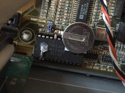

Reply 7 of 12, by overdrive333

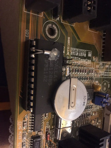

mine p55t2p4. 32,768hz quartz + 30yr battery from famicom cartridge (its still 3v+).
sometimes everything can be done with improvised means and without waiting for deliveries)

Reply 9 of 12, by BitWrangler
Speaking of improv, I made a CR2032 holder out of the top of a water bottle and a drawing pin. cut the screw part off the bottle, put the drawing pin through the cap, tacked a wire on the pin of the drawing pin, trapped a wire under the screw "sleeve" I cut off the top of the bottle, and trapped the CR2032 against the drawing pin on the cap with it. Need a small diameter bottle neck though, regular soda/pop bottle size is a tad too large.

Reply 11 of 12, by jmarsh
overdrive333 wrote on 2023-11-02, 22:20:
From the other photos, you probably could have traced the battery supply pins back to diodes and used the existing battery location on the board rather than bending the chip's pins up.
(Often there's a blank spot on motherboards for a crystal connected to pins 2+3 too.)
Reply 12 of 12, by overdrive333
jmarsh wrote on 2023-11-03, 07:00:
There are no battery or crystal place on p55t2p4. It was designed to use all-in-one dallas 12887 (hate it)
