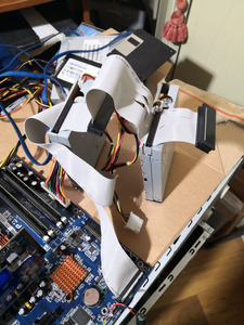

Reply 2 of 4, by GianDO76
CharlieFoxtrot wrote on 2023-11-02, 11:04:
First, the drive A should be at the end of the floppy cable (after twist) and B at the middle. With a normal twisted cable both drives should be configured as drive B (this should be something like DS1, DS2 etc., depends on the drive) amd which should be the default from factory except perhaps for some ancient drives which were installed before twisted cable became common. Twist at the end of cable forces that drive to function as drive A.
My bet is that one of your drives is jumpered wrong. There also might be an issue with the cable. Have you tried another cable?
I think I connected the floppy drives correctly. You can check the attached photo. With another cable the problem is the same.

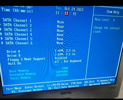

Reply 4 of 4, by GianDO76
CharlieFoxtrot wrote on 2023-11-02, 14:01:
And you have configured both A and B drives in the BIOS correctly (usually in the Standard CMOS features tab or equivalent)?
Yes, they are configured correctly in the bios
