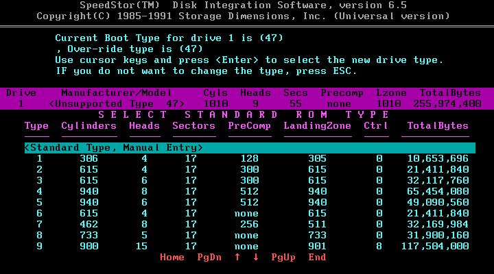

Reply 1 of 9, by Grzyb
Try SpeedStor 6.5 - it should list the HDD parameters table in ROM BIOS...
7.72 KiB
522 views
Another software worth trying is Checkit Pro.

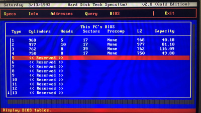

Reply 5 of 9, by Susanin79
Was able to find application that can read BIOS and display all supported types. And those settings are slightly different from the M290-25 manual.
Here it is, put it there for the history purposes 😀 Now it will be easier to find proper drive.
Type 1: 968 Cyl 5H 17S
Type 2: 977 Cyl 10H 17S
Type 3: 762Cyl 8H 39S
Type 4: 750Cyl 8H 17 S
    1.35 MiB
    437 views

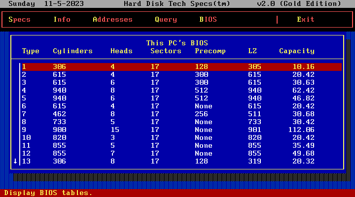

Reply 6 of 9, by Grzyb
Susanin79 wrote on 2023-11-05, 14:53:
But have you tried SpeedStor or Checkit Pro?
I want to know if that "Hard Disk Tech Specs" is any better than the above...
Nie tylko, jak widzicie, w tym trudność, że nie zdołacie wejść na moją górę, lecz i w tym, że ja do was cały zejść nie mogę, gdyż schodząc, gubię po drodze to, co miałem donieść.
Reply 7 of 9, by Susanin79
Beg my pardon, didn't know that SpeedStor can read the standard types from BIOS, as I always use a custom type. It was so easy 😀 And yes, SS shows the same table.

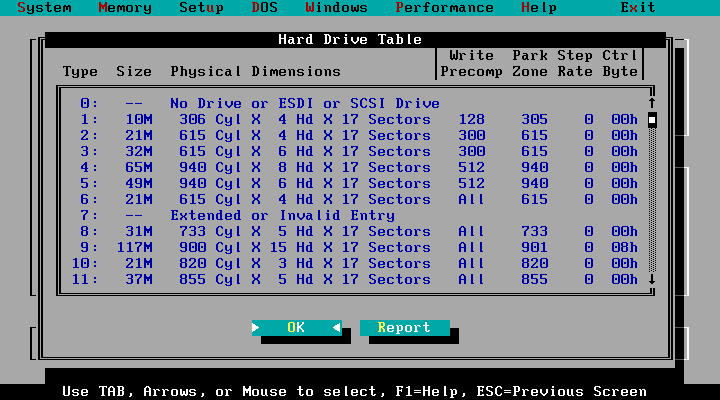

Reply 8 of 9, by Grzyb
So I tried the three programs on my 486...
6.37 KiB
395 views
5.58 KiB
395 views
7.72 KiB
395 views
Checkit Pro 1.11 lists some entries as "Extended or Invalid", while the other two can't see any problem with them...
Anyway, that Olivetti BIOS is really limited - only 4 predefined types.
Even the earliest IBM AT BIOS (01/10/84) supports 14 types.
