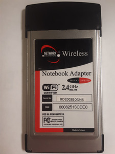

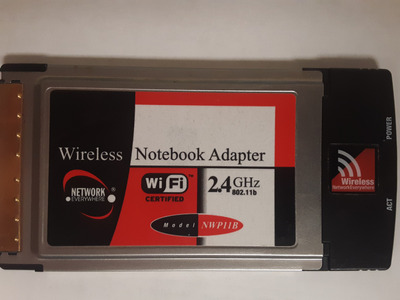

I'm looking for Windows drivers for the Network Everywhere NWP11B PC Card. Unfortunately I just have the card itself and no driver CD.
I found a driver download from https://www.driverguide[.]com/driver/detail.php?driverid=151034 The zip file seems to be missing some files. Definitely a sus site.
I've also tried seeing if the driver was archived from the OEM site on the Internet Archive bit I didn't find anything.
If you happen to have a driver for this card, I would be grateful if you uploaded it to archive.org. Probably also upload all the other drivers you have for obscure hardware that can't be found on the internet.

What version of Windows ? Driver Guide is reputable as long as you search proper, never got a virus from anything there (yet) and have DL'd 100's of things.
archive: http://web.archive.org/web/20031220195259/htt … p11bsupport.asp
the driver link points to FTP but lists same files as DriverGuide...
so you need the driver: ftp.networkeverywhere.com/nwp11b_drivers_v2.1.10.2.zip = https://www.driverguide.com/driver/detail.php … driverid=151422
and best to grab the utility: ftp.networkeverywhere.com/nwp11b_utility_v1.05.zip = https://www.driverguide.com/driver/detail.php … driverid=785944
and the manual: ftp.networkeverywhere.com/nwp11b_ug.pdf = https://www.manualslib.com/manual/951752/Netw … #product-NWP11B
Looks to me the utility has drivers and config stuff for Win98, WinME, Win2k and XP.
this page has some good info: https://wikidevi.wi-cat.ru/Network_Ever ... ys)_NWP11B
the NWP11B is also knows as Linksys WPC12 and BroMax WE302-TF. Same Texas Instruments ACX100 + Maxim MAX2820 chipset. Also D-Link DWL-650+ are made by same Global Sun Technology and use same chipset...https://usermanual.wiki/Global-Sun-Technology/GL242201MT/amp and https://usermanual.wiki/Global-Sun-Technology/GL2422040T/amp
