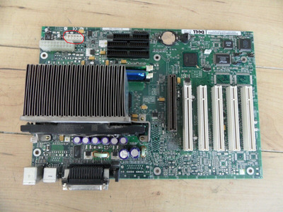

I want to build a Slot-1 system with RAMBUS... and a saw this Dell motherboard on eBay.
It has an AT style AUX power connector... is it optional?
The ATX power connector should work with any standard PSU, right?
Thanks!

VivienM wrote on 2023-11-03, 23:26:
This is probably the 'standard' proprietary Dell power connector that they used at that time.
Incorrect.
This is Dell power supply pinout and you can buy this adapters online.
https://www.ebay.ca/itm/234303646117?hash=ite … ABk9SR_yUtfjyYg
Either this adapter or move the ATX connector over (soldering, not easy if you are not skilled with soldering).
Cheers,
Great Northern aka Canada.

Reply 4 of 5, by VivienM
smtkr wrote on 2023-11-04, 00:26:
pentiumspeed wrote on 2023-11-03, 23:31:
Incorrect.
Sarcasm went flying over your head 😁
Right - by 'standard', I meant the proprietary Dell power connector that is widely discussed in this forum, that has adapters available on eBay, etc. So while it may be quite proprietary, it is also... well-understood... as opposed to some weird proprietary things that might have only been used on one low-volume model.
