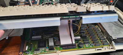

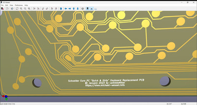

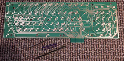

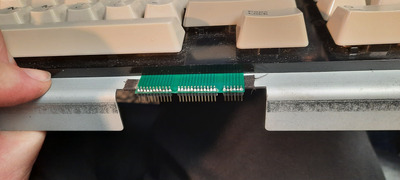

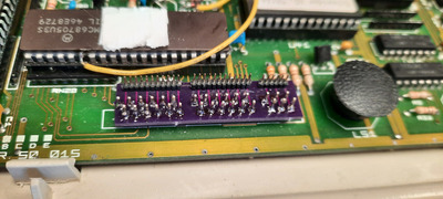

First post, by microtronichamburg
https://github.com/lambdamikel/europc-keyboard
https://youtu.be/OTO-QyZ73c4

Reply 1 of 2, by mkarcher
Thank you very much for sharing! I have a Euro PC with multiple faults, and one of the faults is indeed the flex cable from the keyboard to the mainboard. Your solution looks like a quite nice solution if I can't fix the flex cable.
I wonder why you use a single-row high-density connector instead of the (in my oppinion) more standard dual-row 2.54mm connectors (which will be crimped to the same kind of cable). Are there space constraints making the "standard IDC solution" impossible?
Reply 2 of 2, by microtronichamburg
mkarcher wrote on 2023-11-06, 20:19:
Glad it's potentially helpful - yeah I guess it would have been possible, but the space is kind of tight. Also, the PCB is very flexible, so putting in standard pin IDC headers would have been problematic from a stability point of view I think.
