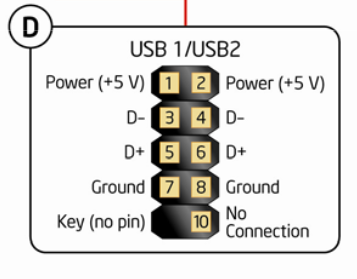

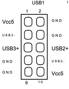

On my old Acorp 6BX86, there's one USB 10 pins connector.
And I don't have its original extender.
I installed it into ATX case and its 2 front USB sockets are connected by a 9 pins plug.
So I checked pinouts and it turns out that the one with 9 pins has same signals on left and right side,
while 10 pins one has left and right side rotated (see images).
I was able to connect one of front panel USB sockets by shifting the plug one row aside. But I'd like to have a nice adapter to connect both sockets.

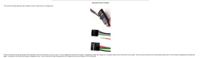

You ought to be able to customize the case's USB cable by (carefully) lifting the plastic retainers and arranging the pins to match. Image shows a pair of five pin connectors, but the procedure is the same.

Buy some DuPont pin connectors and make an adapter. Just triple check the Vcc and ground connections, otherwise you'll blow a pico fuse on the motherboard.
