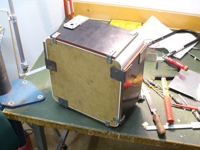

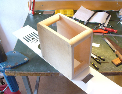

This build actually started over 15 years ago, when the Socket 7 was already an old platform, but probably not considered retro. I had this DFI K6BV3+ based system I got for free from a friend, which I used to start experimenting with Linux. I hosted dedicated game servers for private LAN parties on it and tried out other shenanigans. When the precompiled hlds linux binary dropped i586 support and the system became obsolete for its former usage I came up with a new use for it. I was pretty big into case modding back then and dreamed about building a high class casecon with a real purpose. Nice Network Attached Storage devices weren't really a thing at the time and the few available were rather expensive. So I started designing, constructing and building a slick and compact case around the Baby AT motherboard to use it as a NAS. Here are some pictures from the build process (remember, this is 2008):
The attachment P1020447.jpg is no longer available
The attachment biegung.jpg is no longer available

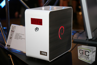

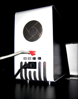

I actually got admitted to the German Casemod Championship 2008 (DCMM) with a half finished case (3.5" HDD lying outside) and the gamescom Casemod Masters with a pretty much finished build later that year. Although I didn't make it to the podium the case was received very well and I was really proud of it.
The attachment enas.JPG is no longer available
The attachment C12-eNAS-01.jpg is no longer available
The attachment IMG_5305.jpg is no longer available
