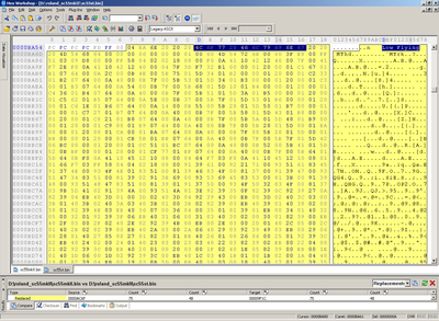

I've just made dump of SC-55st ROM (CRC32: 8f51dd3c), it's 256KB in size. So, SC-55mkII ROM dump available online is 512KB (CRC32: fcee1e8e), but the last 256KB are where the Demo Songs are stored/located, i.e. they could be ignored for the purpose of this discussion.
So, comparing the 1st block of 256KB from SC-55mkII ROM with SC-55st ROM reveals very few differences, they both are the same version:
GS-28 VER=2.00  SC
i.e. no doubt, 55st is just stripped-down 55mkII without display, etc.
what is surprising though is the biggest 16KB difference between the two ROMs is where in those 256KB of SC-55st ROM they made special effort to squeeze, the "Low Flying" Demo Song, here is screenshot showing that:
70.24 KiB
1722 views
what I don't understand though - how is supposed to play that demo song - there are no buttons or display on SC-55st , yet from the ROM structure it's obvious special effort was made that Demo Song to be included in the 55st ROM?
any thoughts and/or ideas? maybe some special press-sequence of the Power Button activates the playback of the demo song, but it's just a switch and cuts the power, it makes no sense?I don't know...
[EDIT] or maybe there is some special "factory testing mode" - where they short something on the main-board as part of the testing at factory and that triggers the Demo Song to be played. that makes more sense...
