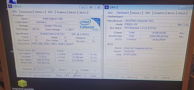

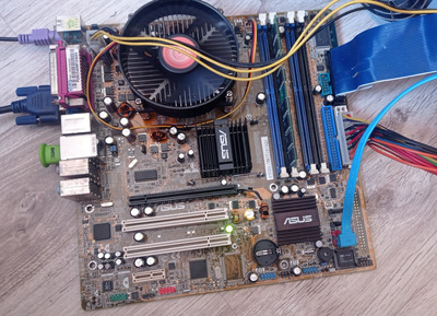

In September 2023 I got Asus P5GD1-VM board, with i915G chipset:
The attachment board.jpg is no longer available
For joke I tried to put pin-modded Celeron 440 to it, to see if it will at least show POST codes, but to my surprise, it POSTed 😳 So BIOS for that board for some reason have code to initialize Core 2 CPUs.
Spoiler
This is only BIOS for i915 based board that can initialize Core 2 CPU, I was super lucky to get that board without even knowing!

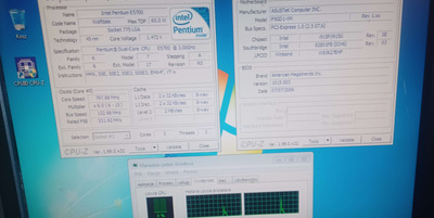

So after that, I was tempted to try Pentium Dual-Core based on Conroe core, but it hasn't POSTed, it got stuck at code C2.
I put that board away cuz I didn't had any new ideas, but later I tried Pentium Dual-Core based on Wolfdale core, and that was unexpected, it POSTed and BOOTed into OS fine!
It detected 2 cores correctly 😳
The attachment 20231010_111132.jpg is no longer available

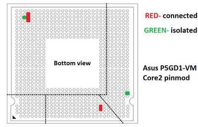

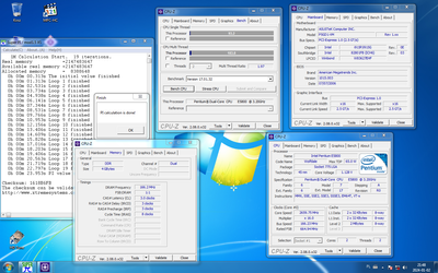

But multiplier was stuck at 6x and FSB at 533MHz (Celeron 440 did same but BSEL mod managed to make FSB 800MHz work)
For multiplier problem I used throttlestop program, for FSB I did BSEL mod but... FSB 800MHz does not POST, only 667, still better than 533 I guess 😜
This is how final pinmod (for E5800) looks:
The attachment pinmod.png is no longer available
Now some new (and better) pictures 😁
The attachment cpuz.png is no longer available

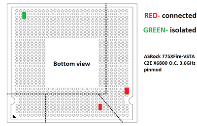

Now time for second topic, Conroe and 925X chipset.
I used Core 2 Extreme X6800 (only C2D with unlocked multiplier) and ASRock 775XFire-VSTA board.
The attachment IMG_20231228_214421.jpg is no longer available

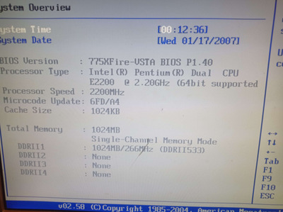

This board is interesting one, it have official support for Cedar Mill CPUs, and newest BIOS is from 20 December 2006.
When I saw i925x board with such new BIOS I thought "it must have code for Core 2 initalization", and I was right! I just needed to add microcodes. 😁
The attachment IMG_20231228_164201.jpg is no longer available
BIOS works flawlessy with Conroe based CPUs, Wolfdale is different story, sometimes it doesn't POST and seems to be not so stable. But that's ok I already have 2 i915/i925 boards with Wolfdale so why not Conroe this time 😀
I tested C2E X6800 on different board to see how much I can overclock it with acceptable voltage, 3.6GHz at 1.45v (stock voltage is 1.35v) is best I can get. Still solid clock for (originally) Pentium 4 only board 😁
This board does not POST with 1066MHz FSB CPUs so I did BSEL mod to lower it to 800MHz. This is how pinmod looks like:
The attachment pinmod2.png is no longer available

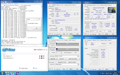

Some pictures from Windows and BIOS:
The attachment x6800.png is no longer available

Microcodes are not getting loaded for Wolfdale CPUs on this BIOS anyway, so you can use stock one.
For isolating I just used regular tape, for connecting, hmm... you can use silver conductive paint (for permanent use) or copper conductive tape (to test if it works).
At least I did it that way 😁
