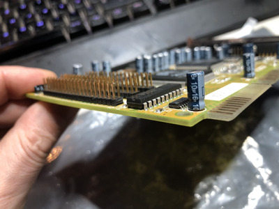

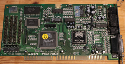

I have a BTC-1820 Oak Mozart card here that I must have forgotten I reclaimed the capacitors on for some ungodly reason, and I need a list of all the values. I can make some educated guesses such as C69/75/84 all needing to be 16v 10uF due to placement but I'm clueless for most of the rest.
Also missing a 24.576MHz crystal but I have a few dead cards I can scrounge one off of in short order. The PAL chip for the cdrom interfaces is also missing but it has always been missing.
1.04 MiB
330 views
oh no!
I want to get this running again as it's a card that so far as I know can be enumerated properly by Unisound, and I'm going through and testing out a bunch of cards in my inventory for weirdness.
It doesn't look like anything else is missing, but in order to get it working again for testing, I need a cap list to proceed. I've seen a few threads where the board is discussed so I know it's a somewhat common enough card.
Any help towards a fully functional card is greatly appreciated.

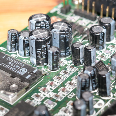

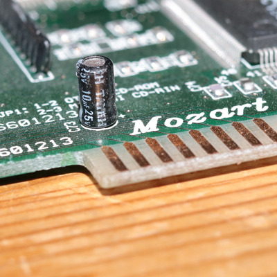

I can help somewhat - I don't have the same card as you but it's very similar in that it's just the one with the OPL4 wave table chips compared to the OPL3.
1.44 MiB
275 views
The ones on the edge of the card that are used for smoothing voltages on the digital side, like the C69 and C75 capacitors are all 25v 10uF.

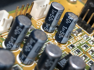

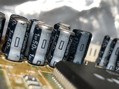

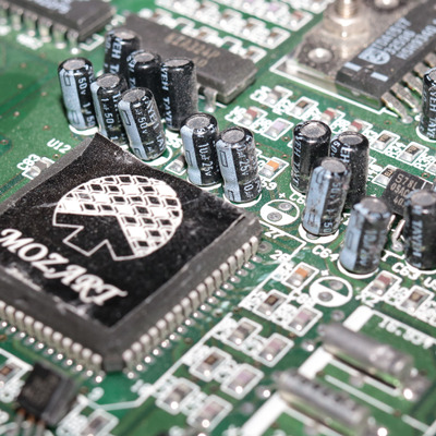

The ones coming off of the CS4231 audio codec which are part of the audio path are pretty much all 50v 1uF.
There appears to be a 25v 1uF in one spot on mine but having a 50v where a 25v should be should make little difference. edit: this was incorrect, there's a mark to the printing that made me think it's a U instead of a 0 at C58 on my card - really that's a digital cap hooked to the Ground plane that goes to the KIA324P op-amp.

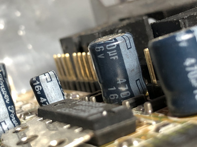

The big caps (C16,C18,C19) on the TDA1517 are 16v 470uF.
The other large caps which I think are C14, C27, C29 and perhaps that says C28? it's the one on the opposite side of C29 down by C27, those are 16v 100uF.

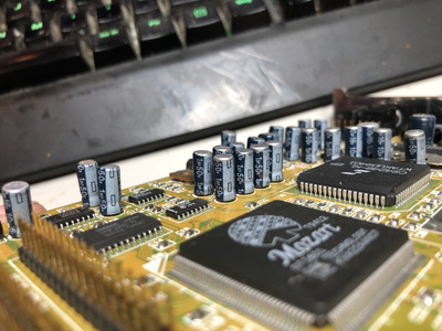

Your card has some caps that mine does not and I can only guess what goes there but looking at the rest of the card, caps that go into the ground plane (C9, C12) are digital caps and should be 25v 10uF. Then there are caps that do not hook to the ground plane and should be part of the audio path (C10, C13, C23, C24) and those should probably be 50v 1uF.
You also need to re-fit the 7805 regulator and the 24.576MHz crystal.
Hope that helps you get your card working 😀 Although I can't assist fully since my card is different I can potentially measure and check stuff if needed.

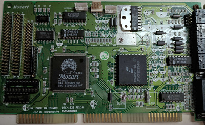

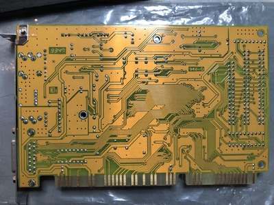

I have another Mozart variation. Maybe it helps.
FCKGW-RHQQ2
Reply 3 of 5, by DerBaum
More pictures
edit: added picture of backside
FCKGW-RHQQ2
Reply 4 of 5, by Thermalwrong
Huh, the PCB designer for that yellow PCB must've gone to Asus after working for that company - so odd seeing the filled in part of the circle on the silk-screen be the positive side.
