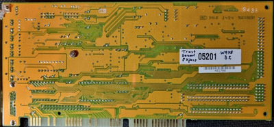

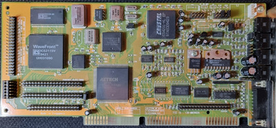

Got a Trust Sound Expert Wave 32 sound card which looks like to be the same as an Aztech Sound Galaxy Waverider 32+ according to the specs in this post Re: Help to Identify Aztech ISA Sound Card.
It is recognized as an Aztech Sound Galaxy Washington 16 in Windows 95 though. But whatever driver I use it always is using 2 IRQ's. One for SB (=5) and another one for something else (7 or 11 depending what is free). That is excluding IRQ 2/9 which is used by the MPU-401 on the card.
The second IRQ is a mystery for me. Where does it come from and by what it's used? It can only be set to IRQ 7 or higher in Windows 95. In the DOS config tool I can only see one IRQ which can be set (besides the MPU-401). Anyone knows?

Can you post a picture of the card?
When i search for it on google it looks like a OPTI card not Aztech.
Maybe its the IRQ for the IDE connector?
See attachments for pictures. I disabled IDE in the config utility already. Also I disabled Windows Sound System just to look if that made a difference. But 2 IRQ's are still used.

I got a copy of the original floppies for this card. But can't use them as they are probably for Windows 3.1. Installing them makes Windows 95 not starting up again.
But if I look in the SETUP.INF on those floppies I see a line "Wave IRQ=7, 9, 10, 11" in it. So it seems the Wave chip needs a separate IRQ (besides the SB and MPU-401 IRQ).
Makes sense I guess but it's a bit inconvenient as I am out of IRQ's. So probably need to disable the parallel port which I tried to avoid. 🙁
