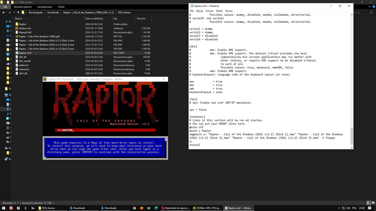

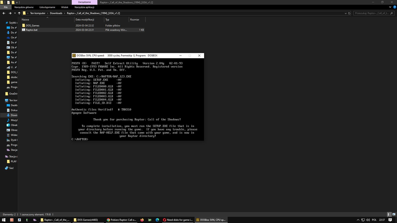

There is only one game I cannot made to install => Raptor - A call of the shadows
Not the method you shared nor anything else could made it install so far. Full, registered version should it be...
I am not sure if this is legal or not:
Can anyone help me to install the game (I send the zip archive) then zip it installed and send me?
After installation the directory and it's place means nothing, thanks for DosBox's mounting procedure.

I had no problem installing this game..

I would not be able to install this stuff.
It turned out the second disk is corrupted. It were suspicious when Total Commander took near two minutes to copy that from the old CD...
To bad, this game were one of my old favourites.
