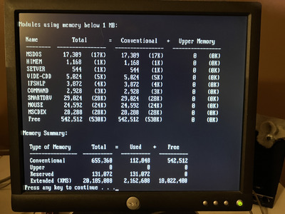

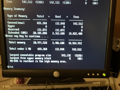

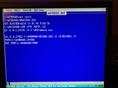

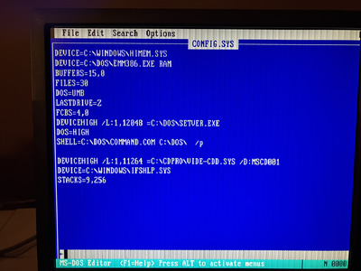

Reply 9 of 17, by LadyAIluros
Okay this is my current config.sys and autoexec.bat. I commented out the line about EMM and ran the memory command.
RE: Exault, I don't use Windows, all my daily drivers are Macs 😁
I am using MS-DOS 6.22 and the Unisound drivers for the Vibra 16.

Reply 10 of 17, by Dominus
Rank DOSBox Moderator
DOSBox Moderator
Exult, I don't use Windows, all my daily drivers are Macs
Exult is a multiplatform program, running beautifully on macOS (as I am a mac user myself).
In your config.sys, disable emm386, ifshlp.sys and the CD driver (put REM in front of the lines).
In autoexec.bat disable smartdrv and mscdex.
You need as much conventional memory as possible.
And just to make sure, did you setup the soundcard in Ultima 7‘s install.exe?

Reply 11 of 17, by LadyAIluros
Dominus wrote on 2024-02-08, 05:44:
Exult is a multiplatform program, running beautifully on macOS (as I am a mac user myself). […]
Okay that seems to have worked - I assume that every NOPC does not have spoken lines, I don't think we were there yet but I can load in and walk around and it is hell on a hard drive, wow does the drive put in work. It's a 486DX/50 so I know it has the power to run this, but it feels slower than U6 was on the same machine. (I don't know what the min spec was for U6 tho....)
Thank you!!
