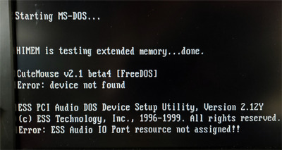

This evening I tested the ASUS PVI-486SP3 using the BIOS from the Beyond 486IP-B-2-A. The latter uses a 1994 AMIBIOS.
Unfortunately, I couldn't even get the ESS Solo-1 to detect for the most part. Running ESSOLO.COM would typically result in a freeze with the error message: Error: ESS Audio IO Port resource not assigned!!
295.17 KiB
354 views
After some trial and error, I eventually managed to get it to detect on IRQ 10. However, sound testing still didn't work as it just resulted in repeated stuttering.
I'm at a point where it seems there is just something fundamentally incompatible with this motherboard.
