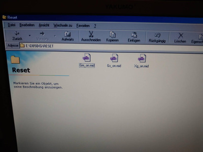

Reply 3 of 8, by Demolition-Man
Found a CD in the Archive.
Does anyone have any further information about this?
