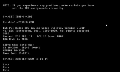

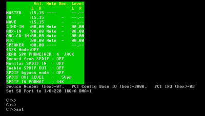

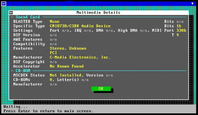

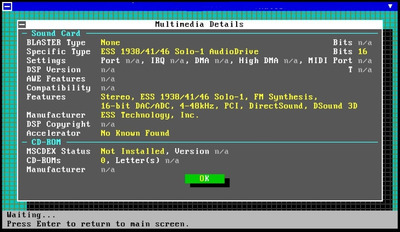

I have the following setup: Fujitsu Futro S550-2 (D2963-A1), MS-DOS6.22, and two sound cards, ESSOLO-1 and CMI8738.

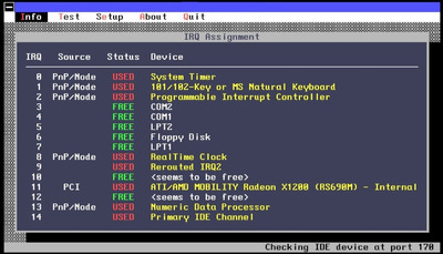

With the equipment mentioned above, I am facing the following issue: neither ESSOLO nor CMI want to work, they are detected by the system, but both cards choose IRQ=11, even though 5 and 7 are free.
In the case of ESSOLO, I used drivers found on Vogons, I tried the Hexxit+ESSOLO.ini method as well as the Pciset method. Regardless, the card still uses IRQ=11.
Given that the motherboard does not have the appropriate chipset (mentioned in few posts on Vogon), will I not be able to run these cards? The BIOS, as befits a terminal-type computer, has a very limited number of settings, and I can't force the card to use a specific interrupt through it.
I also tried to swap the IRQ 11 with 5 using SwapIRQ, but without success.
