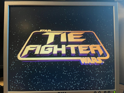

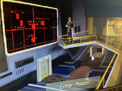

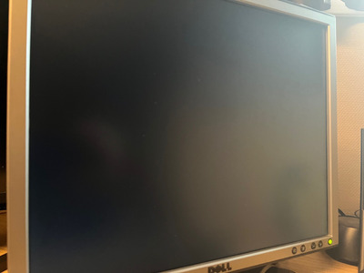

I'm trying to play Tie Fighter on my 486.. everything works fine up until I go into "Enter Mission"... then I get a black screen any nothing more happens.
The intro plays just fine with sound and music. I am able to go around in the "base", but as soon as I enter any kind of mission (same in training/simulator room) I get black screen.
I am using:
486 DX2-66
Tseng ET4000 (VLB)
SB16 CT2290
Have tried disabling all sound and different speed settings in setup, but no luck.
How do I troubleshoot this?

The graphic card is a Tseng ET4000/W32i (VLB), could it be a compability issue?
I believe these cards has very high compability with DOS games, right?
Are there any graphic card tweaks available for DOS gaming?
Reply 11 of 12, by swaaye
It could be a VESA VBE issue. You could look for a Tseng VBE TSR or try UniVBE. TIE Fighter might already be loading a version of UniVBE. The game may also have compatibility options for VGA modes. Maybe command line options. Check the readme.
And you could look for the DOS CD version of TIE Fighter which has the SVGA mode and maybe additional compatibility tweaks, and includes both expansion packs.
