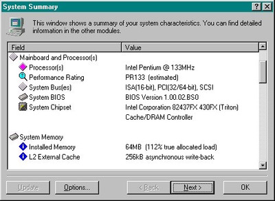

Reply 11 of 16, by Shagittarius
Just tested this on my P133 430FX and it installs and runs fine from the original CD.
