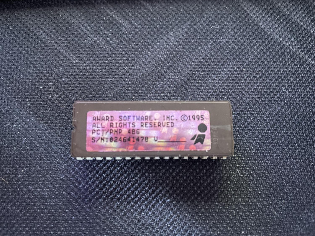

i realised, that the bios chip looked almost identical on this one and on the firs motherboard that i brought the Tm-486sps.. so i swapped them.. suprisingly it worked so now it recognise the cd rom drive.. and the cache chips, but still the com ports are not working.. So i am thinking to go in the other way and instead og buying a fourt motherboard, i just gonna buy a com port extention card..

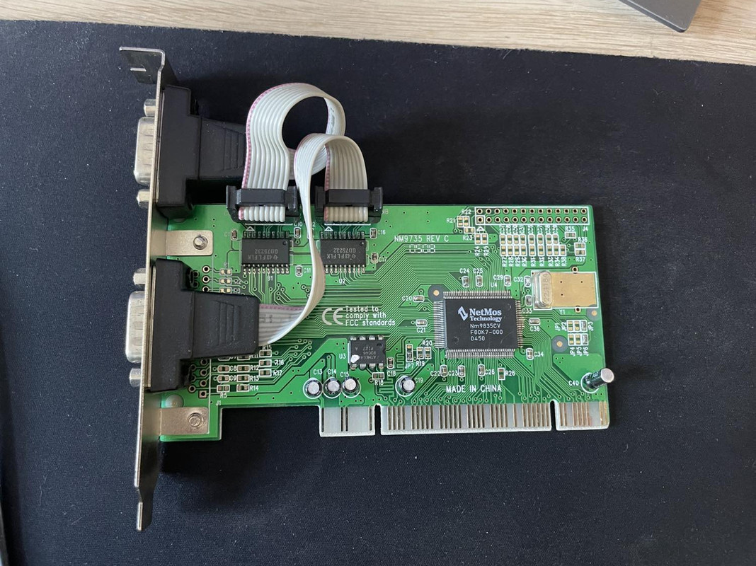

I brought a https://www.ebay.com/itm/175250303600?mkcid=1 … emis&media=COPY card which seems quite new to me.. so i am not sure if it has a dos or win 3.11/ or win 95 driver.. so i wonder if anybody here could tell me if its gonna work in my system? Or maybe has a driver for it? I also might could get a card like this https://www.ebay.com/itm/125342592133?mkcid=1 … emis&media=COPY
Since this is a isa card, i hink it might fitt better with my rig, and might could work in dos , but i stil couldnt find a driver for it.. Also the seller who has the card told me that the last time he used it wan 27 years ago.. and wasnt be able to test it ever since, so it might not work . But anyway thats where i am at now.. i only would need to make the com port working and than i would get a nice system..
Reply 1 of 39, by dominusprog
Yes, these EEPROMs can be identical, but what matters is the ROM itself. So my suggestion to you is to find a different version on the retroweb and flash the BIOS.
OPTi MAD16 / Creative Vibra16XV ❇ 8.4GiB Quantum Fireball ❇ Win95 OSR2 Plus!
Reply 2 of 39, by RagingSquirrel
Well.. it is working with the other chip fine.. only wierd thing is that at the boot it says that it is the Tm-486sps motherboard while it is a KM-S4-1. But i wonder could it be the chips fault that the com ports not working? also how could i flash the bios?

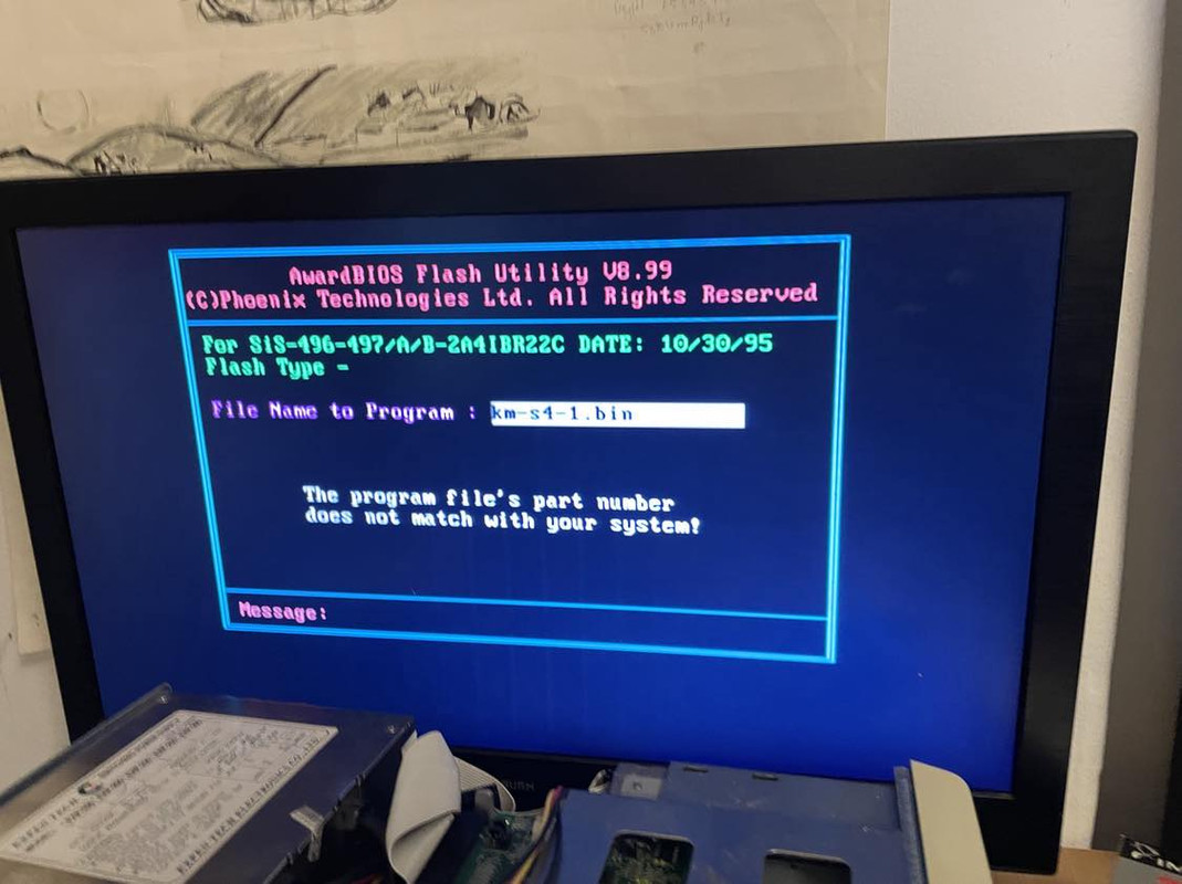

Reply 4 of 39, by dominusprog
You can use AWDFLASH or Uniflash, but you have to know what exactly you're doing. You can also take the chip and give it to someone with an EEPROM programmer.

Well first since i already ordered it i gonna try to use the com port extention card if it works i gonna leave it as it is.. if not i gonna try to update the bios by buting back the eprom chip that the motherboard come with .. if i mess up the bios update i can just change the eprom chip bac to the one i have it in right now do i?

In order to fix that problem i am buying 2 different com port extention cards one pci and one isa… i wonder if its gonna work as plug and play, or do i need drivers for it. Because i only found drivers for the pci and its only for win 7 amd above so i am mot sure if its gonna work at all.

Reply 19 of 39, by the3dfxdude
Frankly I would just wire up your internal com ports correctly. But if you insert that i/o card, you really should just turn off the com ports on the motherboard in the bios at that point. I'm not sure what your pci based com driver can support for i/o port addresses and irq so you'll want to check up on that to know if it will work for you.
