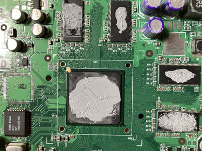

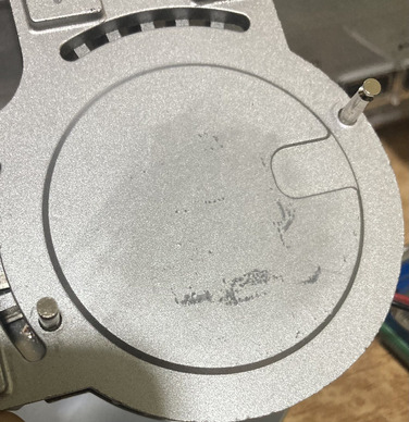

73°C on desktop... What the hell? With this massive heatsink? When I touch the heatsink, its not even warm. Of course I changed the termal paste, and seem like it has bad contact with chip cover. Can it be fixed or this fine temps? What is ambient temperature btw? LEADTEK-WINFAST-A310-GEFORCE-FX-5600-256MB-LR2950-Chlodzenie-powietrzem

Yea, 134 is set by default, I can't change the temperature threshold, but 150°C sounds crazy. I've attached a photo. Still maybe the issue is with the bad contact? Because there's barely any thermal paste on heatsink..

Reply 7 of 36, by pete8475
nuvyi wrote on 2024-03-03, 21:23:
If that's how little contact there is you should add more paste. Air is far worse than lots of paste.

Reply 8 of 36, by kingcake
Did you get paste on the components around the die? There's usually a thermal sense diode. If you get thermal paste that is conductive or even capacitive on it, you will get crazy temp readings.
I've had to fix this many times on repaste jobs people did.
One reason I like MX-4, you can smear that all over exposed components and nothing will happen, except for making a mess 🤣

Reply 14 of 36, by nuvyi
kingcake wrote on 2024-03-04, 01:26:
And where's that thermal sense diode? I took a photo, did I get it right? By the way, I used exactly MX4.
Reply 16 of 36, by kingcake
nuvyi wrote on 2024-03-04, 09:11:
Well darn, I stand corrected.
I thought sure that was the problem.
Reply 17 of 36, by nuvyi
kingcake wrote on 2024-03-04, 10:08:
Elaborate? Where's this diode exactly?
Reply 18 of 36, by MikeSG
Does the GPU core temp move when you stress the card? Does it get to 80?
There's no way it's hot if the heatsink isn't hot. Paste looks fine
