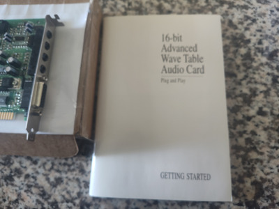

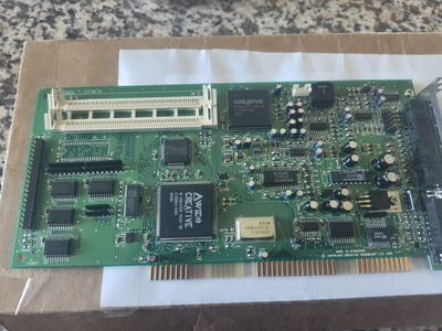

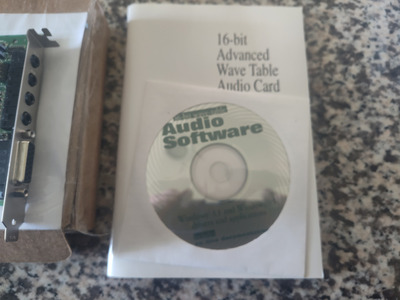

On a whim made an offer on a sound card on eBay that the seller didn't have a good picture of. The only picture was of the card in his hand covering most of the card, the only thing giving it away was the end of the simm slots, the position of a chip next to the slots. My guess was right. The card came with the manual and cd. Appears to be new and seller said he had opened the static bag but who knows

I've seen it discussed elsewhere around here about reflashing these with awe64 firmware but did not see where it was a good idea or not aside from losing the IDE.
Reply 1 of 11, by mkarcher
The data that can be flashed on these cards is not the firmware (which is integrated in the CT8903 chip), but the plug-and-play identification data in the EEPROM U21. The CT8903 is the same "digital-part of AWE32-in-one" chip that is also used on AWE64 cards, so the idea of converting that card into an AWE64 cards makes sense.
The key difference between the "32-voice" AWE32 and the "64-voice" AWE64 is not any hardware difference. The AWE32 wavetable synthesizer (the EMU8000 chip, which is integrated as part of the CT8903) has 32 logical voices, some of which are not available for music playback, but used for internal system purposes. This hardware synthesizer is identical on the AWE32 and the AWE64. The extra 32 voices of the AWE64 are due to Creative shipping a 32-voice software synthesizer using a method called "WaveGuide synthesis" (minimum system requirement: a Pentium processor). The software synthesizer can add 32 voices on top of the "32" hardware voices. As these two synthesizers are entirely different General MIDI synthesizers, the same instruments sound different on the AWE32 wavetable synthesizer and the WaveGuide synthesizer, so the voices do not get dynamically allocated to whatever synthesizer currently has spare voices, but you can set up a mapping what instruments should be played on which synthesizer.
I am not sure whether the WaveGuide software synthesizer software checks the device ID of the installed Soundblaster card for being "AWE64" branded, but it surely might do. In that case, the AWE64 card is a hardware dongle used to unlock the WaveGuide synthesizer, and reflashing your device identification data to that of an AWE64 card will allow the WaveGuide synthesizer to run on your system. As this card has not been sold as AWE64, Creative will also not have payed license fees for the WaveGuide synthesizer to Seer Systems, so its technically piracy to use that software with your AWE32 card. Apart from possibly unlocking the WaveGuide synthesizer, there is no advantage of changing the card identification data.
As you correctly state, the card identification data lists all the components of the cards. The card identification data of similar AWE64 cards do not include an IDE port, so the BIOS or operating system has no idea that there is an IDE on your card that could be enabled by configuring the Plug-and-Play interface correctly, and thus the IDE interface disappears. If you want to get rid of the IDE interface in the device manager, you might also want to use the AWE64 card identification data instead of the AWE32 card identification data.

Well, it actually is a good comparison: Just as GPU unlocks just permits the driver to things it wouldn't do without the unlock, without physically changing what the hardware can do, this is also what happens when you change the AWE32 identification data to the AWE64 identification data, you allow software to add 32 extra MIDI voices.

So your system does not require the IDE port. The BIOS might insist on allocating an IRQ to it, causing it to be unavailable to PCI cards, so there could be more shared IRQs on the PCI bus, which might have slightly impact performance. If you flash the AWE64 identification data, the IDE port stays disabled, and no IRQ gets allocated to it.
While you can set in your BIOS which IRQs may be manually assigned to non-plug-and-play cards and which IRQs will be managed by the Plug and Play system of the BIOS, you can not tell the BIOS whether certain Plug-and-Play-IRQs should be allocated to ISA or PCI cards. As an IDE controller is considered a device possibly important for booting the system, the BIOS will go great lengths to try to reserve one of the BIOS-managed plug-and-play IRQs to the AWE32 IDE interface, taking this IRQ away from remaining IRQs that can be used for PCI cards, which are served from the same "Plug and Play IRQs" pool.

Another question about the card. Was this an OEM model because the manual and cd don't look like any of the ones I ever got buying Creative products in the past? I've found other creative manuals that look like this one but most seem to be a bit more, dare I say stylish!
Reply 6 of 11, by chinny22
Thats how all my creative manuals look.
So probably not retail but maybe generic OEM from the good old days when each town had a local computer shop building beige PC's.
