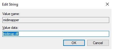

I was using Bassmidi for a long time, I liked the different soundfonts when playing old games. Recently I could not find Bassmidi so I downloaded VirtualMidiSynth. Everything worked fine. Then I followed a video where they told me to alter a string using Regedit.
The string is "midimapper" found in Computer\HKEY_LOCAL_MACHINE\SOFTWARE\Microsoft\Windows NT\CurrentVersion\Drivers32
The basic value for this is "midimap.dll". I edited it to "VirtualMIDISynth\VirtualMIDISynth.dll"
After doing this Microsoft GS Wavetable Synth disappeared. I uninstalled VirtualMidiSynth then reedited the string in regedit to the original "midimap.dll" rebooted and still there is no sign of Microsoft's built in Synth.

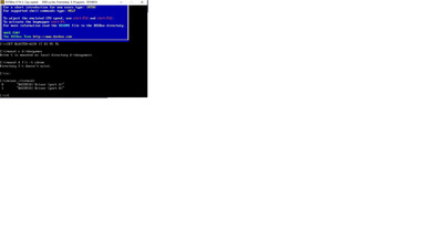

For Dosbox it is not a problem, I can use Bassmidi or other synth programs and use the midiconfig = % to set the desired midi channel.
However right now it most programs that use Midi (for example Age of Empires 1) are silent because they would like to use GS Synth but they cannot. VLC player also complains that there is no MIDI device.
In Dosbox if I use "mixer /listmidi" there is NO Microsoft GS Synth listed.

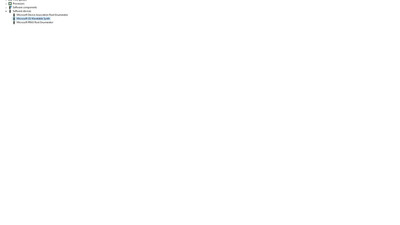

I checked in Device Manager under "Software Devices" and I can see "Microsoft GS Wavetable Synth" just working fine. Tried disabling / enabling it, uninstalled it, reinstalled it...nothing helps.

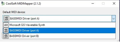

In VirtualMIDISynth, what devices show up under MIDI mapper?
It shows everything, even GS wavetable but it does not work. If I uninstall Bassmidi then Bassmidi is obviously not on the list.

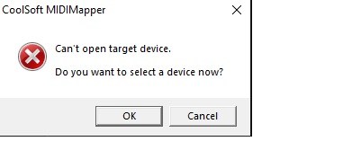

If I set the default MIDI device to GS Wavetable and start a program that uses midi - for example Dosbox - it shows me the attached error message. "Cant open target device".
If uninstall the mapper and bassmidi then all these programs simply remain silent. So the current "solution" is that I use this third party MIDImapper and set it for Bassmidi as default....this way after loading a sound font at least I have a midi device but GS Wavetable is just not working which is something I have never seen before.
Again, the string value in regedit is right, I got the midimap.dll file right in the System32 folder and Device Manager shows it as "working properly". I just don't get it.

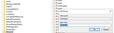

It was this key: "HKEY_LOCAL_MACHINE\SOFTWARE\Microsoft\Windows NT\CurrentVersion\Drivers32"
String name? Midimapper, value = midimap.dll.
Checked it a thousand times, it is fine and midimap.dll is in System32 folder as it should be....I see no evidence of corruption. The GS Wavetable just does not work. I don't think it is a compatibility issue, I think it is an issue with Windows.
