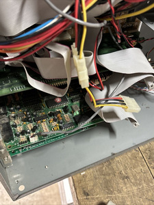

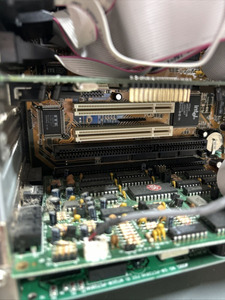

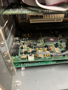

I'll start. I was sent pictures of this odd sound card in this old custom built PC, but I am unable to get anything clearer or more direct.
The attachment sc1.jpg is no longer available
The attachment sc2.jpg is no longer available
The attachment sc3.jpg is no longer available
The attachment sc4.jpg is no longer available
Things I notice:
2 black plastic 3.5mm plugs on one end, Volume dial, one metal 3.5mm plug in the middle, gameport
Looks to be an 8bit ISA card, though it is a little hard to tell
Total length of the card is only about as long as a 16bit ISA slot
I see none of the usual "squarish" shaped chips that you'd find on a later, more highly integrated device, and there appear to be a lot of discrete components... reminiscent of a card from the very early 90s, and yet not huge.
CD-ROM and PC speaker, audio input.
Some larger chips... possibly an OPL2?
The rest of the PC looks newer, with what is probably an Intel 430HX or 430VX board and I believe an S3 Virge.
It doesn't appear to be a Sound Blaster of any kind, so it is probably some obscure clone of an SB 2.0... but it has even less integrated components than the old CT1350B and yet is smaller. Quite puzzling!

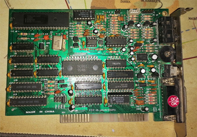

keropi wrote on 2024-03-20, 18:51:
yep, this is almost certainly a SB2.0 clone card kinda out of place in a p1 system though […]
edit: 🤣 , by pure chance this exact soundcard is on sale on AmiBay - seller says it's a "master boomer"
there are 2 pals on the card that is why it is small in size
Amazing! Thanks Keropi!
I love hunting for stuff like this. I could pick out the important details but I have never heard of a "Master Boomer" so it's no surprise that one didn't turn up in my searching. Were you looking for it when you found it on Amibay or was that totally by chance?
I'm assuming the SC801 is an OPL2 clone. It also looks like the person who took that pic moved the QC sticker on theirs, but it is still there at least. 😁
... and L O L ... Master Boomer... 🤣
EDIT: Found a thread here about that card, or at least one with the same FCC ID:
Protac AV202P3 - Can anybody tell me *anything* about this card and how to get it working?
Reply 3 of 5, by keropi
it was pure coincidence
and yes, the SC801 is a known OPL2 clone - and on the amibay card the 74LS74 weird looking chip on the right side is the DAC clone

Reply 4 of 5, by kixs
What a coincidence... I've bought the card on AmiBay and then saw this thread about it 🤣
