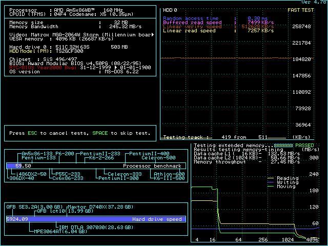

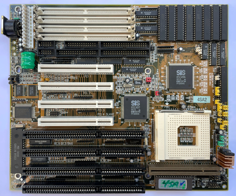

Reply 1514 of 2164, by pshipkov
In continuation to Chad's post about Soyo 4SA2 at 200MHz (4x50) i am adding few more notes for Am5x86 at 160MHz and POD100.
Mine seems to be a new old stock.
The box:
Its contents:
The logic board itself:
Soyo produced several variations of the 4SA series.
The 4SA2 here is the most advanced design - PCI, VLB, ISA, 1024Kb level 2 cache, proper support for POD83/100 (P24T) processors.
There are several BIOSes available. They all suck in different ways.
Later revisions break VLB compatibility.
Some result in faster PCI graphics at the expense of VLB and vice-versa for others.
Upon closer inspection it was concluded that IO-B1 is best for VLB graphics and SA-0730 is best for PCI graphics.
Ark1000VL cards work with this motherboard but require 1 wait-state for POST to start. S3 Trio64 VLB and other cards can work with 0-WS but are slower than Ark1000VL in DOS interactive graphics.
FPM RAM is supported only. Tested with a single 32Mb stick.
Tried 2x32Mb as well everything looked fine, but during testing there are multiple restarts and mem counting is added small annoyance, so most of the runs were with 32Mb only.
Jumpers settings are a mess.
Control over L1/L2 write-through/back modes happens entirely through jumpers, regardless what BIOS says. Took a moment to sort that out.
All tests were performed with BIOS settings on max except DRAM WRITE CYCLE = 1WS (best is 0WS).
L1/L2 caches in write-back mode for best performance.
Clock generator has support for 60 and 66 MHz, but no jumper wiring.
Didn't bother exploring that since Chat already showcased what happens at 200MHz.
--- Am5x86 at 160MHz (4x40)
benchmark results
Some concerning things:
- Doom test never finishes. Tried hard - most conservative BIOS settings, disabled L1/L2 caches, different video cards.
- LightWave3D rendering test never completes. Tried hard - same as above.
--- POD100 (P24T at 100MHz)
Updated the comprehensive 486 mobos + POD100 CPUs post with information about Soyo 4SA2.
You can find everything there and see how it stacks against the rest.
The short summary:
Middle of the pack performance.
Unstable Doom test - concerning.
All in all - not a bad assembly.
But the stability issues with some of the tests are hard to ignore.
