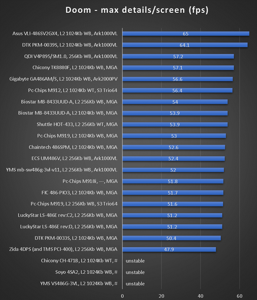

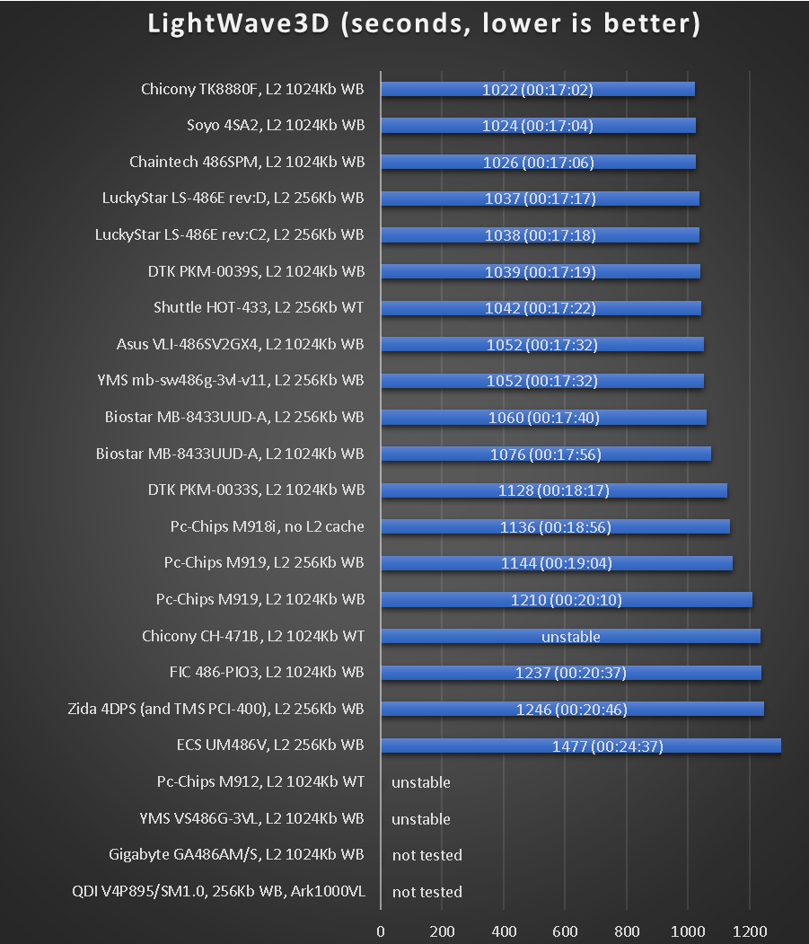

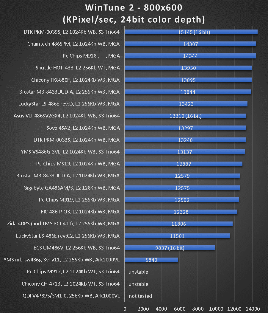

486 class motherboards with Intel Pentium Overdrive P24T (POD100) processor running at 100MHz (2.5x40)

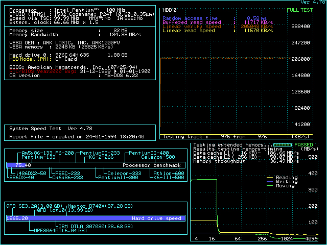

For example the Biostar MB-8433UUD-A rev.3.1 SpeedSys screenshot below shows IDE speeds in the range of 5Mb/s, while with Sanddisk Extreme CF it can go +1Mb as shown in the original POD100 post (link above).
Leaving the subject for another time. It requires proper testing of different mechanical HDDs, CF cards and SSDs to find the upper limit for each motherboard/controller.
At this time i go by the common denominator as a basis for comparison.

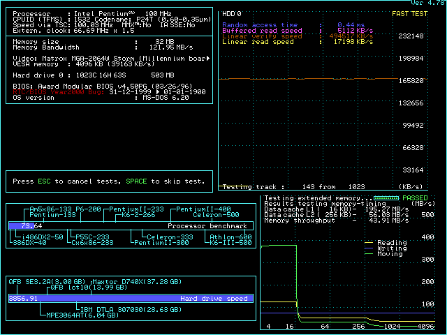

Asus VLI-486SV2GX4 revision 2.1 with Promise EIDE2300 Plus VLB EIDE controller
Biostar MB-8433UUD-A rev.3.1 with 256Kb L2 cache with IDE driver version 3.2 and /D0:16 /MM0 /F0 flags.

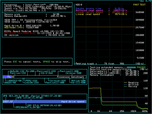

Biostar MB-8433UUD-A rev.2 with 1024Kb L2 cache
L2 CACHE WAIT STATES = 3-1-1-1 (or higher), otherwise BOOT does not complete.
SpeedSys hangs on "YEAR 2000 bUG".

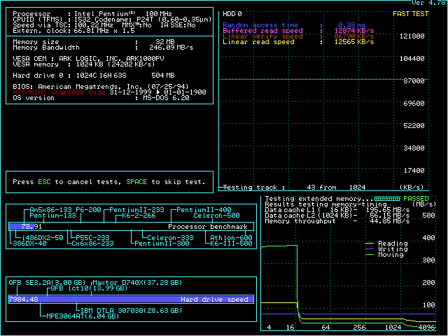

PC-Chips M918i revision 1.2 with the only know IDE driver for ALI M1489/1487 - ALIHDD.SYS and /T /S20 /PIO:4AAA /IOW:YNNN /BKM:YNNN /LBA:YNNN flags.
L2 cache disabled for best performance. This was covered extensively in previous posts.

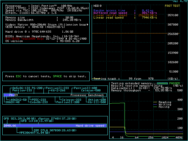

Zida 4DPS version 2.1 / TMS PCI-400-4
TMS PCI-400-4 is less stable than Zida 4DPS version 2.1 in general.
Screenshot shows no L2 cache, but it is actually there. Delta is too small for the limited vertical resolution of the graph.
Performance is slightly lower if L2 cache is disabled from BIOS.

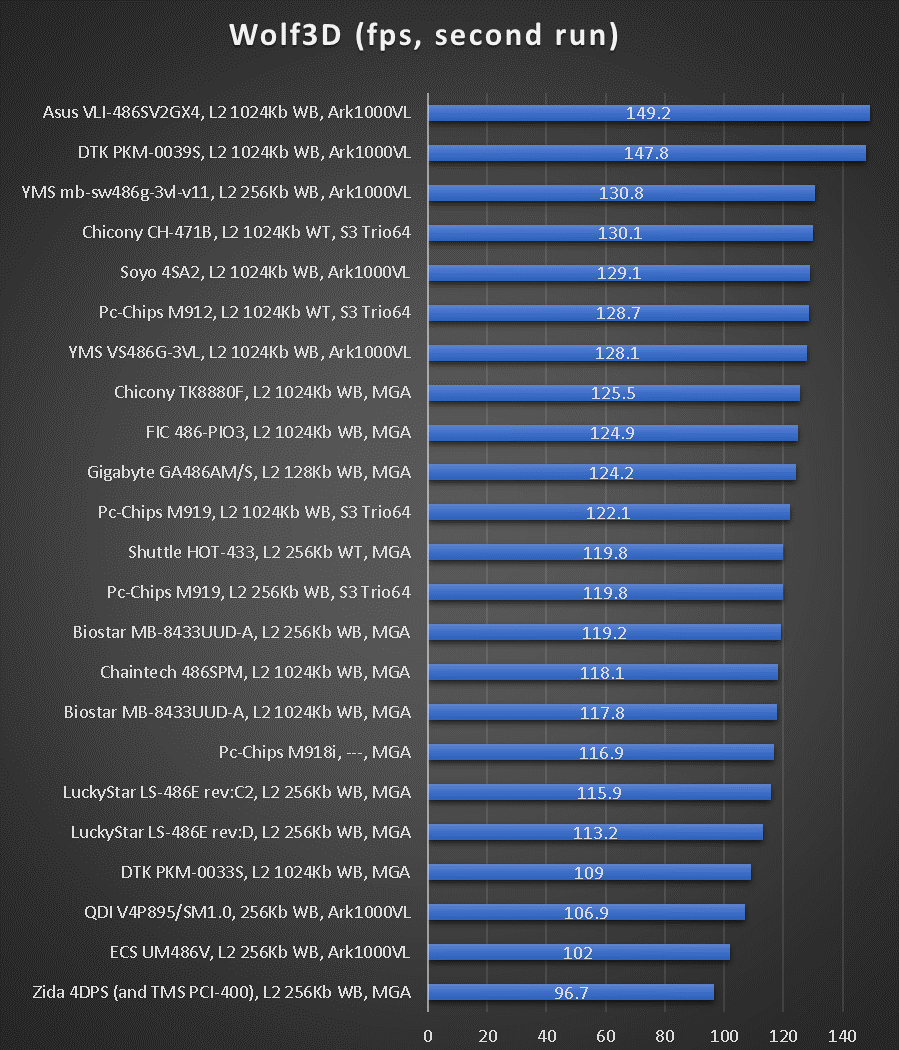

--- benchmarks
For clarity - the WinTune2 test is for Windows accelerated GUI.
Few things to notice.
VLB > PCI for interactive DOS graphics. Not a big surprise here. It was already established by Am5x85 based tests in previous posts. Now confirmed and with POD100 CPU.
Small format SIS based boards are consistently last in line.
It was the same with Am5x86 processor.
Notice the Chicony guy.
One of many with Am5x86 at 160MHz.
Did well in the DOS tests with Am5x86 at 180MHz, but completely failed in Windows and complex computation.
Didn't work with Am5x86 at 200MHz.
But with POD100 - surprise surprise. Who would know.
Top notch interactive DOS graphics and Numero Uno in the most complex test - LW3D rendering.
Also, notice DTK's PKM-0039s.
Surprisingly good performance. Suddenly VLI is not that far ahead in DOS graphics and IDE speed.
Best accelerated Windows GUI with VLB hardware to date.
While numbers look great, here is the bad - it does not support Am5x86 CPUs.
In fact it does not support Intel 486DX4-100 CPU, only up to i486DX-75.
Worse, it has an issue with 1024Kb L2 cache. Frequently enough it will refuse to boot until L2 cache is disabled from BIOS, then restart, then enable it again, then restart for complete boot.
This is not related to BIOS timings or other settings - just BIOS gets in a weird state and either needs to be cleared, or the above exercise has to be performed.
So, cannot recommend that board really.
Otherwise the story repeats itself - Asus VLI-486SV2GX4 is again the highest Socket 3 place, this time with POD100 processor.
