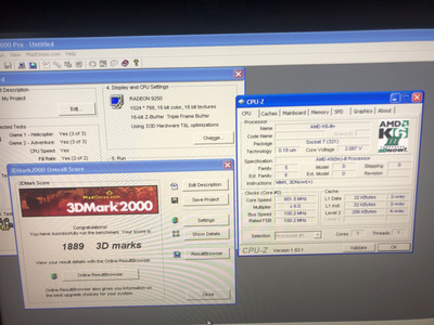

Hello,
I am sure I am not aiming anywhere here.
Soltek 56G5 (512kb cache)
K6-2+ @ III+ 600mhz
512mb c2 crucial
Radeon 9250 256ddr 128bit catalyst 5.11
Xp SP3
GeForce 5200/5700/mx 440 all cause reboot on any 3D application start.
Really do not know why.
I use 4x interleaving and write allocation utility.
What can I do?

Took a look at your board
Use three, single sided 128mb sticks. Not double sided
You may be able to get a radeon 9800 to work.
A geforce 2 or 3 might get better scores. But I never had much luck with them.
Use the onboard usb. Don’t use a usb card.

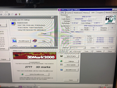

Reply 568 of 657, by Mamba
Alright,
It seems to be a dxdiag glitch cause both Rivatuner and CpuZ tell me that agp is operational at 2X.
I ended up doing this with my R9250 128bit (attached).
Not sure if a change in driver might help (support is welcome)
But I have the feeling that the motherboard’s caps are falling apart as the FSB is floating around.
That said, I can enter Windows at 133mhz FSB (then freezes).
Because of the weak state of the motherboard, I am not comfortable at overvolting too much to search for stability.
Plus, I may be out of luck with the AGP out of specs that does not cope with ATI in general.
Just a note:
With a fx5700 that should be supposedly a lot faster, I have 900 points less…. What a nonsense.
