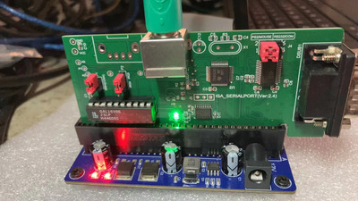

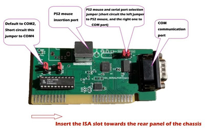

I have a 486 pc with a FIC 486-PVT motherboard , with a controller card which only supports serial mice, and I was in need to use a USB one. I found some solutions here like PS2toserial which is sold in serdashop and another PS2 isa card from RIO , but price and availability made me look if aliexpress had something and well it did.
you can query " ps2 to serial isa " in Ali's search bar to find it.
PROS:
-price (I got mine for US$ 18 + US$3 for shipping)
-It works
CONS:
-No documentation
-Odd position of the PS/2 connector (WHY??)
-No brackets
-mouse movement is ok but needs a little bit more accuracy/responsiveness (edited)
At first I was using CTmouse and couldn't get it to work , then I disabled the COM ports on the ISA IDE controller via jumpers and well nothing.... But when i bought this pc , there was a Genius mouse driver and it worked in DOS and windows 3.11. (I haven't tested it further)
It does the job but i'm wondering if I can improve accuracy , reading here I learned that maybe I should get COM speed up to 9600, and try microsoft mouse driver to increase polling rate, maybe to 100hz.
**Currently using a USB optical mouse => USBto PS2 adapter => ATEN KVM => 486 PC**
Hope this info is useful because I couldn't find anything about this adapter.
Any tips to increase accuracy? Thanks!

I was testing againg and the lag/accuracy was due to the kvm. When using it with my computers with ps/2 ports there wasn't any.

My board is labeled "ISA_SERIALPORT(Ver:2.4)". I desoldered the com-port because it got in the way.
Mod to use a breakout header for the PS/2 signal:
I was hoping the left header was the 4-pin PS/2 pinout, but it was not. Not sure what it is. I desoldered the PS/2 receptacle.
The holes below it are in standard order, pin 1-6, going from left to right, down to up, so it becomes pin 2 GND nearest the PC rear of the ISA card, pin 1 CLK below it, pin 3 DATA up and right, and the top rightmost pin is pin 5 V5v. The pins are unfortunately not spaced in the 2.54mm standard pitch, so a normal header row won't fit. I soldered one pin at a time instead.
In my case I had to also connect ground to the outer ring of the new PS/2 receptacle, that's what my grey/final cable does. That last step is probably not always necessary, and depends on the model of PS/2 receptacle you are using.
