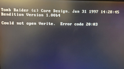

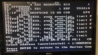

Hello
I have seversl prop.3d card such pcx1, ati rage, s3 virge, matrox impression+, rendition v2200, matrox mystiq.
Which Dos game or program is the best for testing most of them? I have gd5464 laguna 3d too.
I find tomb raider has many versions, pcx1, pcx2, s3d, ati rage, matrox myst, 3dfx, rendition
I have one pc with s3 virge, 3dfx voodoo with cd drive.
This pc working good both s3d and 3dfx patched version. ( i download patches from https://tombraiders.hu/letoltesek/category/17-tr1-patchek )
I have a testbench without cd drive, but with fakecd ( https://www.math.uni-rostock.de/~nfa506/fakecddr.html )
Its working with Matrox mystiq, and ATI CIF, but with rendition v2200 pci got error message, attached, and with pcx1 a strange resolution with error message too (attached)
Is anyone who successfully run pcx1 and rendition version with these hardwares?
Thsnk you any advice!

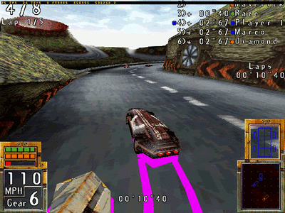

Has it been confirmed that POD does anything meaningful with S3d?
I'm using a wrapper and seeing that all it's sending to S3d are the handful of untextured triangles for car shadows, the rest is rendered in software. PODS3DX.EXE and WPODS3D.EXE both do it, and both depend on the S3d DLL.
I guess it's something that you get alpha-blended shadows (I'm assuming they're blended anyway) vs. the software renderer's stipple, but a bit of a stretch.

Reply 688 of 700, by vvbee
Here's a clear one. Everything S3d renders is shown in purple, the rest is CPU: https://www.youtube.com/watch?v=wHigYglY10o.
137.01 KiB
762 views
A couple of polygons in other words, all black with an alpha of 128 and no texture. A good guess would be that whatever the software renderer would stipple for alpha is rendered through S3d for alpha blending.

Which 2D card are you using for PowerVR? Unlike for 3DFX, it matters. Both for speed and compatibility.
Reply 698 of 700, by Gona
JustJulião wrote on 2025-02-13, 02:16:
According to vetz and Putas tests with PowerVR Midas3, Rendition Verite cards give the best compatibility. Furthermore with Tomb Raider PowerSGL patch (both PCX1 and PCX2) there are resolutions which are only available if Rendition Verite is present as a 2D card (although there is rare lagging in the most popular/playable 640x480).
In DOS the Tomb Raider PowerSGL patch (both PCX1 and PCX2) in 640x480 resolution I have found the Cirrus Logic CL-GD5436 as the most compatible (3rd column from the right here).
