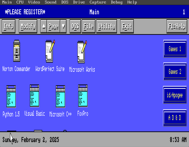

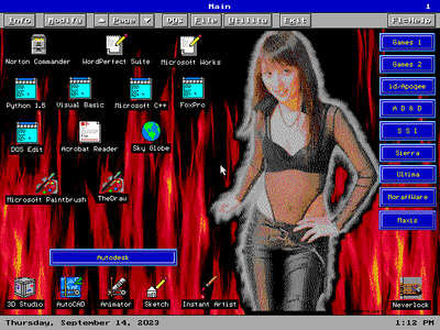

Reply 2414 of 2419, by Dracolich
I've been enjoying dosbox-x for about a year now, especially because of the Daum-like menu bar and save states. Everything had been working nicely through the 20241002 release. When I updated to the 20250101 release, using the same dosbox-x.conf, something happened to the video mode that I can't figure out. So far I've only noticed it in QuikMenu - it launches with an error about not enough memory and then appears in a low res with vertically stretched icons and status bars. I can load the 20241002 release, or Staging, or vanilla DOSBox, to correct the QuikMenu screen; but the next time I use 20250101 it will do the same thing.
I use the SDL2 release and it happens in both Windows 10 (both mingw and vs) and Slackware Linux (using the Fedora el8 rpm). In dosbox-x.conf I use svga_s3 with 4MB memory and Pentium with cycles=max and 64MB ram, and hma, ems, and xms are enabled. I've tried some different settings for the machine, cpu and ram, and disabling ems, but it is not making any difference. I do have an AUTOEXEC.BAT that normally runs when mounting the C drive folder, and I have tried it without the AUTOEXEC. Still no difference.
See the attached screenshots that show my QuikMenu before and after, as well as the dosbox-x.conf
Update 02/11: After updating to the new 20250201 release, which I just noticed two days ago and includes a lot of VGA and VESA fixes, my QuikMenu problem is gone.
