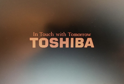

Hello, I have a weird problem after replacing TEAC CD-220EA, XM-1502B and XM-1602B with more modern ATAPI devices. All these drive came to me with Toshiba laptop.
I have tried various more modern drives in satellite 490xcdt, 470cdt and tecra 530cdt and computer just do not starts and
- hangs after testing memory or
- just displays the couple of lines before testing ram.

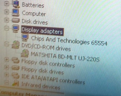

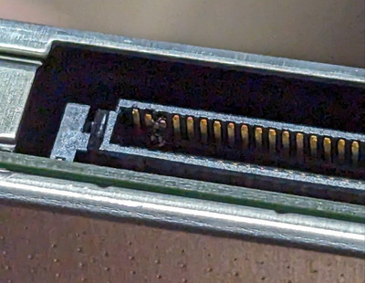

I've had the same issue with a Toshiba 440CDX and it appears to be that the IDE controller expects the optical drive to be configured as Master and most drives are set to Cable-Select/Slave. IIRC there's something about the onboard controller that makes it not make use of Cable-Select and just freaks out.
I've found that shorting pins 47 & 45 will configure the optical drive to use Master and will work flawlessly in a 440CDX. Since I didn't have a soldering iron on hand I used tweezers and lifted the two pins and I've stuck a tiny piece of tin foil in the space and pressed the pins as hard as I could onto the tin foil. After that I've stuck in that interposer piece from the original drive and reassembled everything together. Unfortunately the front trim piece won't fit and the original one won't fit either so it's just bare for now.
It works! It even boots up off of it no problem!
I didn't have any other drive than the MATSHITA UJ-220S... which happens to be an IDE Blu-Ray burner. Kind of overkill, but you know how it is. 😉

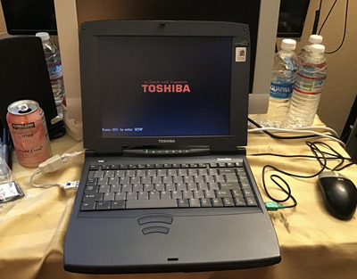

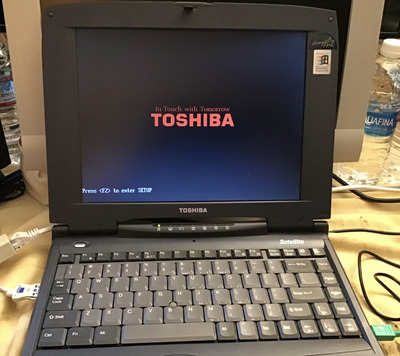

Guys, I bought another 430CDT. It's in really good condition except for a buzzing speaker and a dead CD drive and floppy drive. I know that for the floppy drive you typically need to replace the belt, but I have no idea what to do about the CD drive.
When I click the eject button, the light blinks but nothing happens. If I open it with a pin and place a disc inside, it doesn't even try to spin it.
Maybe it’s a common thing and you got the advice 😀

Yep, you’re right. I moved the metal piece responsible for the lid closing, and now the CD-ROM is fully working! 😀
