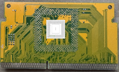

byte_76 wrote on 2025-03-24, 16:25:
Here are the pics of the slotket and the voltage regulator.
as mentioned above, slotket does not look like Coppermine Ready.

I wanted to say it as well - the slotket looks Coppermine ready. The older Mendocino ones usually don't even mention FSB settings past 66 I think, let alone have 133 printed on them.
Reply 23 of 30, by byte_76
It’s absolutely Coppermine ready.
I’ve used multiple Coppermine CPU’s in that slotket and all reported correctly and worked without any issues at 100fsb and 133fsb with correct voltage in the BIOS of my P3B-F.
That said, it’s just a basic slotket and there’s certainly no guarantee that the manufacturer didn’t take shortcuts like skipping non-essential circuitry that may be required for the Tualatin to work properly.

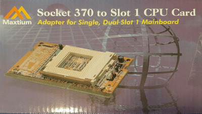

That may mean that the korean adapter is modded to signal for 1.55volt. My suggestion is to follow riplin's earlier suggestion and set the slotket to AUTO and set the P3BF to JUMPERLESS via the JEN jumper. If that does not work then there may be something unhealty going on with the slotket or with the power delivery of the P3BF.
That slotket, btw, is a knock off of the "Super Slocket-III" wich on its turn was derived from the Maxtium CPU370 ver. 1.0.

If Coppermine works on the slotket, but Tualatin does not work, there is a possibility that there is no VTT connection (contacts G35-G37)
The correct Coppermine adapters have a whole polygon for VTT voltage.
As far as I remember, Copper will work without this connection, although according to the circuit design it should be there. Tualatin - definitely won't.
