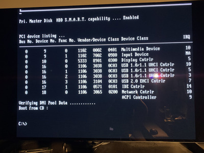

Reply 232 of 248, by jami3rez
Thanks, that CD seems to have worked, everything has installed now!
My new issue is that my PC now hangs for ages on boot. After the Windows 98 splash screen has been up it reverts to this.
TGAztGP
If I wait long enough it does go into Windows and sound is fine.
I’m assuming it’s some sort of IRQ conflict. I’ve tried the card in a new PCI slot, disabled COM and Parallel ports, disabled plug n play, cleared ESCD… I can’t assign IRQ to devices manually, just mark it as ‘reserved’ or ‘PCI DEVICE’.
My PC boots fine if I remove the sound card.
Any ideas?
Reply 233 of 248, by jami3rez
Image link didn’t work, attached it here.

Oh and system -
Athlon xp 2400+
FIC AM39L mono
2 x 256mb 333 RAM
S3 Trio V2 PCI VGA
NEC USB hub
Tried swapping them all around and it hangs still.
Reply 235 of 248, by jami3rez
Tried switching slots again. Now when I reboot it runs scandisk which sticks on 20% and I have to cancel it, then it tries to install the SB16 driver and I get BSOD!
About ready to throw this out the window!!
Reply 236 of 248, by Stretch
My PC hangs on SB16 emulation if I have the parallel port disabled in the BIOS. Can you enable the parallel port again? Maybe that will let you boot into Windows 98.
Win 11 - Intel i7-1360p - 32 GB - Intel Iris Xe - Cubilux 7.1 USB
Reply 237 of 248, by Joseph_Joestar
jami3rez wrote on 2025-03-27, 23:58:
FIC AM39L mono
That motherboard uses the VIA KM400/KN400 chipset, right? I haven't tried that one myself, but I had serious problems with an Audigy1 card on a motherboard with the VIA KT333 chipset. Random crashes and freezes during hard disk activity and such.
Try the VIA latency patch mentioned in this thread and see if it helps. But yeah, sometimes a certain hardware combination sadly just won't work.
