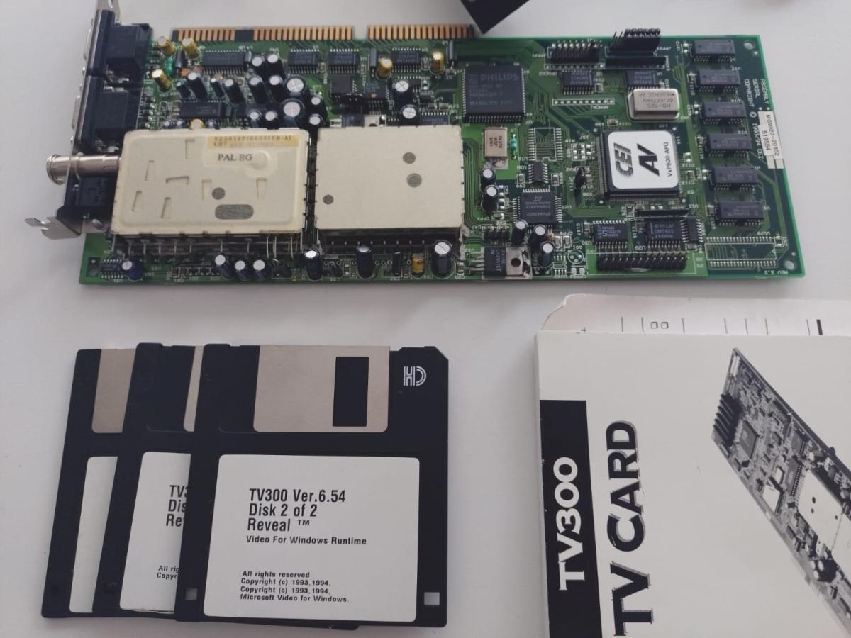

I just won this TV/Capture card for my 486 for EUR 27.49 on eBay:
It comes with the driver disks as well as all of the required connectors and appears to have never been used. (If I can get it to work it will be an interesting addition to the 486!)
I'll run my ZX Spectrum through it in Windows 3.1!

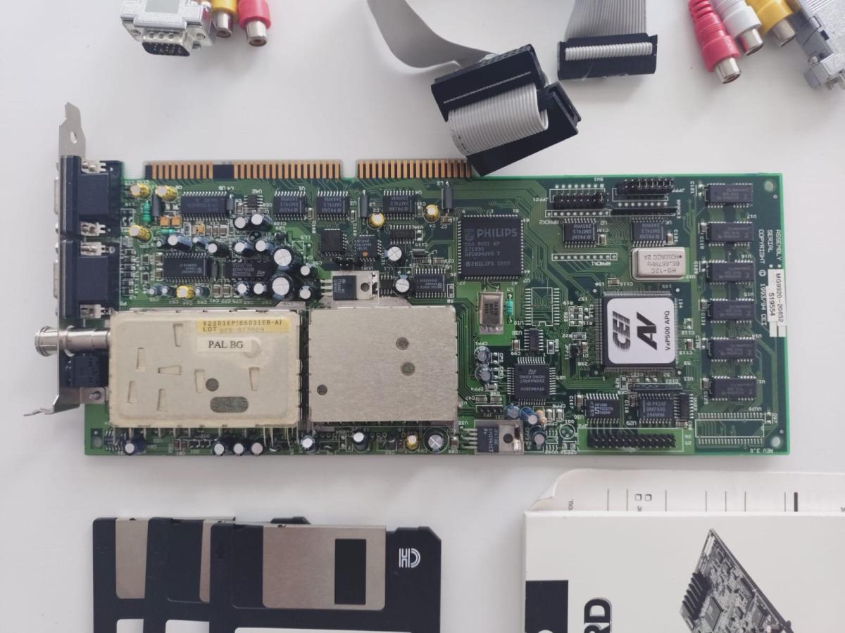

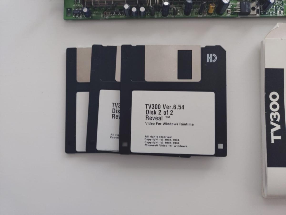

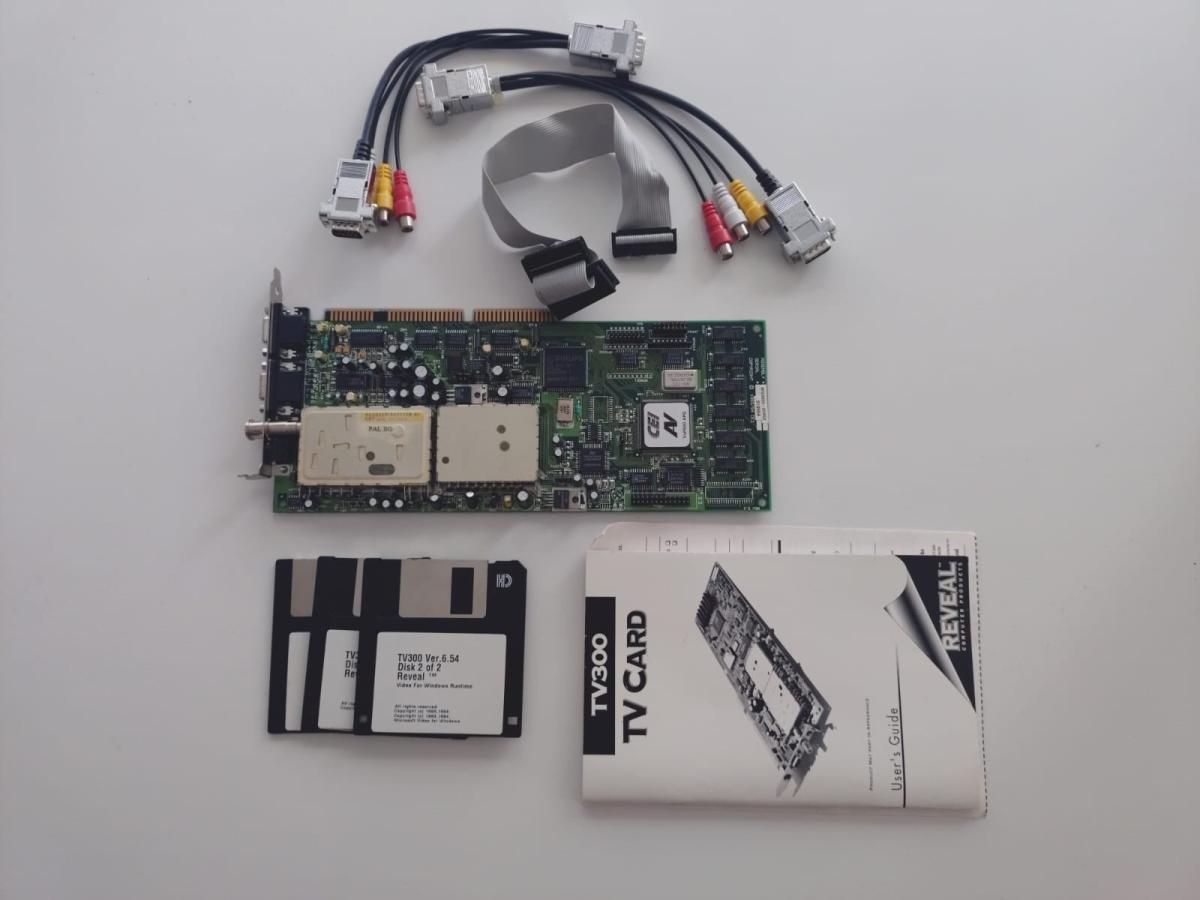

My TV/Capture card has arrived from Germany:
There was one corrupt file on the second driver disk (PROFDISP.EX_), but I managed to download a copy of it! (So I have the Driver and application software for it! 😀 )
