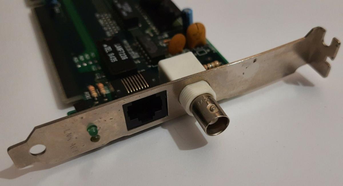

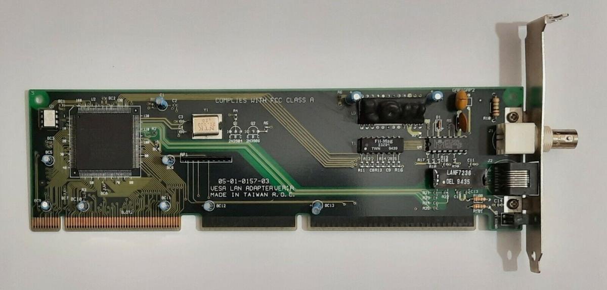

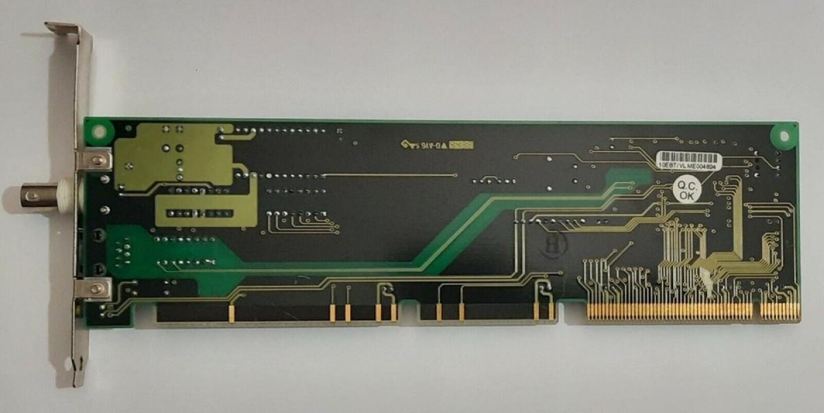

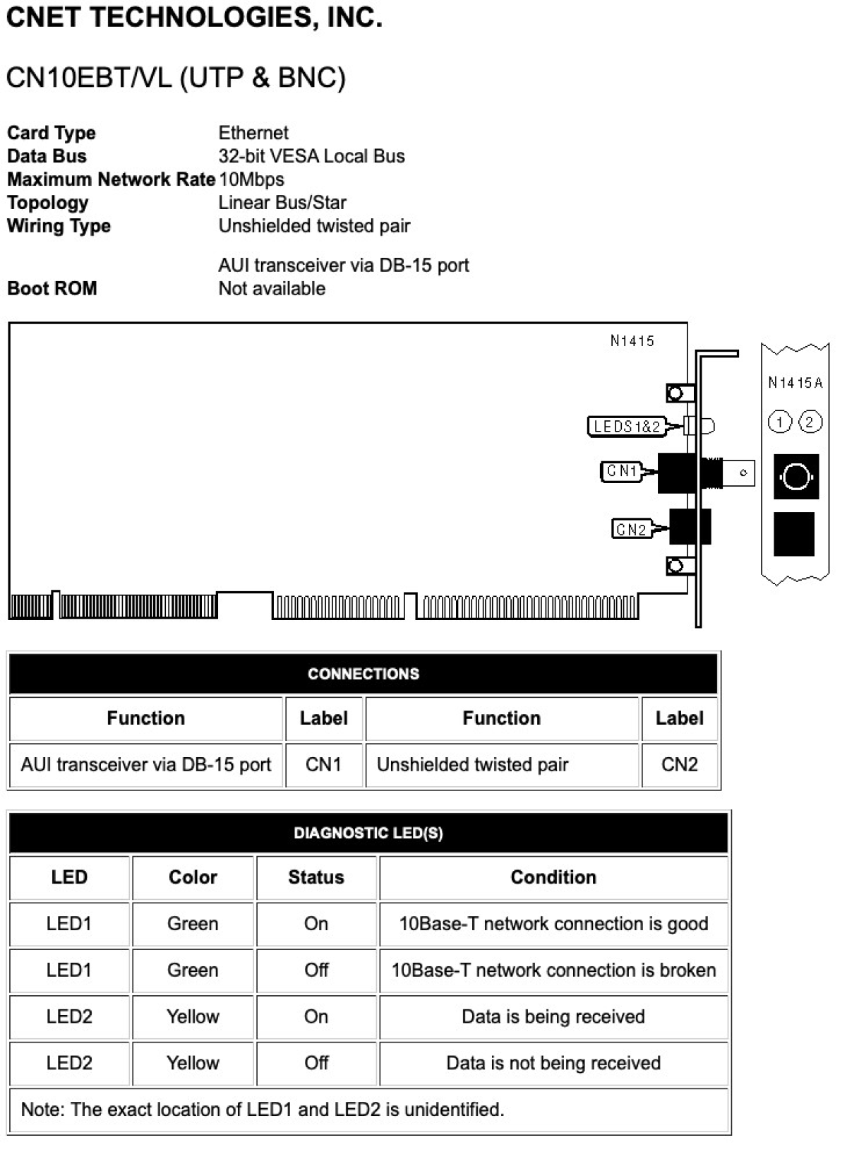

I just purchased this VLB network card for the system rather than a Diamond Stealth VLB, as It's a rarer option: (CNET CN10EBT/VL VLB Network Card)

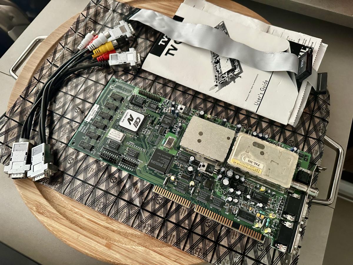

My TV/Capture card has arrived from Germany:
There was one corrupt file on the second driver disk (PROFDISP.EX_), but I managed to download a copy of it! (So I have the Driver and application software for it! 😀 )
