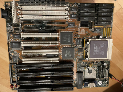

So I got a HOT-433 version 1-3(not v4) to mess around with. I know this is Feipoa’s least favorite board but I thought what the hell, I’ll try it.
Anyway to know what version I have for certain?
I think one thing I’ve learned is that this AM5x86 CPU I have is just temperamental, one day running well on certain cache settings and the next not so much. I’ve seen this behavior on three motherboards so far and the one common factor is the CPU. I need to find a another example or two that runs well at 180.
Anyway was running 2111 cache settings on the 433 all day yesterday, boot up this morning, and it says FU when attempting Quake timedemos.
Other notes:
Using the 5H21 bios from this thread, not sure if it’s the best but I would assume so.
Success: Adding a PS/2 mouse port to the Shuttle HOT433 (using a dedicated keyboard controller chip)
DMA doesn’t work with Rendition Verite cards so far.
I can’t seem to get 1:1 PCI:FSB working at 60Mhz FSB even when using a Promise PCI IDE controller.
I’ve got a 64MB stick but it only recognizes 32MB.
Can’t seem to find the jumper settings for an AM5x86 on the V1-3 boards, I think I have it right based on the numbers I’m pulling. If you guys know where to find these let me know.

Shuttle HOT-433
This one is "fun" for sure.
Pass a picture so we can see what you got.
As far as i remember at 160MHz - all is good. Beyond that - not so much.
But 1:1 was fine at 60MHz FSB. Try to start it with Turbo turned off. Then turn it on once in DOS prompt.
About the memory size issue - did you check if it is not just the BIOS reporting it wrong ?
I have V4 of the board, so cannot confirm jumper settings for you.

Reply 884 of 2436, by Chadti99
Here’s a pic of my board, I think it’s a later revision since it has the keyboard controller dip socket. It is curious that it only detects 32MB of my 64MB memory modules. Everyone else be running 256MB of ram on this board 🤣.
Reply 885 of 2436, by feipoa
Curious, but not surprising. This board is a PoJ. I have two of these boards currently and they both are lemons. I had a third, but it stopped working after a socket swap for the Dallas (why? dunno, I checked it very carefully). I had a 4th and a 5th, but I dumped them in '03. Maybe you'll find a magic board, maybe you won't.
Try different modules. This board prefers EDO, surprisingly.
Reply 886 of 2436, by pshipkov
the exrerior can really trick you - all the right things on display - late 486 chipset, 4 memory slots, up to 1024kb L2 cache, 4 PCI slots, 4 ISA slots, multi i/o.
on the inside - apparently not so much.
But to be fair v4 here is just fine at up to 160MHz. No major complains really.
