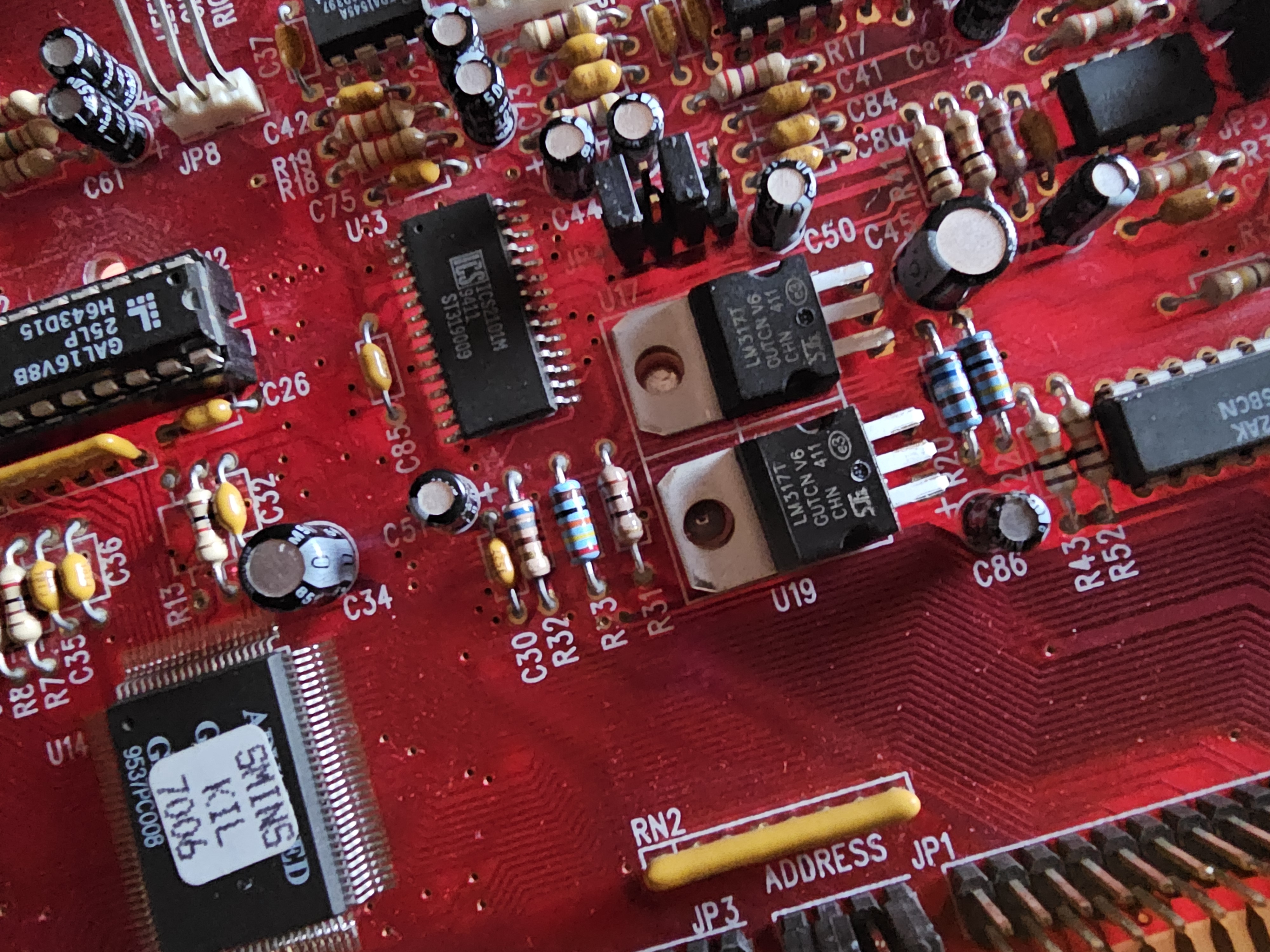

So I got the card and tried to get it working for the last two days. I skipped Windows all together and installed the DOS drivers. Card detected, 1mb of RAM detected, all setup tests passed, no IRQ/DMA conflicts/ errors/freezes whatsoever.
The only problem: I can't get any sound out of it!
That's when I noticed the card has of it's LM317 voltage regulators missing. Really strange, I lookes around google and all other GUS seem to have them. I don't know if the card just didn't come with them or if they were intentionally removed.

have you checked the software mixer settings?
Post a nice clear photo of the board if you can.
Reply 6 of 19, by YetAnother98dude
Yes, I checked the mixer settings and every value was set to 0. But according to the -h command all values can be set from -56 (I think it was) to 0 so I assumed that wasn't the issue.
Here is the card.
Some components are missing: U17 and U19 - two LM317 voltage regulators it seems.
And below the GAL IC R13 and and C107 are unpopulated. I already ordered the 317s but I don't know the values for the resistor and the cap.

Reply 7 of 19, by keropi
R13 and C107 are not populated so do not worry about them
Reply 8 of 19, by YetAnother98dude
What about U17 and U19? Are they necessary for getting sound from the line-out?

Reply 10 of 19, by keropi
YetAnother98dude wrote on 2025-03-04, 10:05:
Yes, absolutely necessary
Reply 11 of 19, by YetAnother98dude
Ok, thanks for the answers. Like I said I ordered them already, should be here later this week.
I'll let you know if it worked.
By the looks of it the IC were cut off from the board as there are still small remains of the legs visible. Weird.

Update: The card works!!
Adding the two LM317T ICs did the trick.
