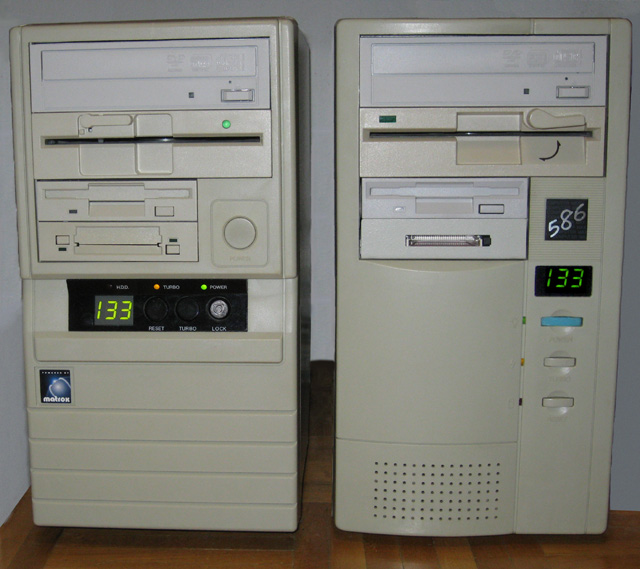

I am curious what everyone would consider to be the world's best PCI-based 486 system. Included in the term 'system' would be models/types of,
1) Motherboard/Chipset/Cache
2) CPU
3) Memory
4) Harddrive/Controller
5) Graphics
6) Audio
7) NIC
8) Operating system
9) Other features like USB, PS/2 mouse port, etc.

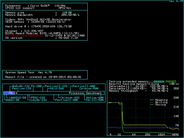

The desired application for such a system would be general, such as retro gaming mixed with office-oriented applications. Benchmarks screenshots have been included on page 3 of this thread.
The intent of the question is not so much as an individualised component comparison (like what's the best Graphics card), but more focused on the best combination of items 1-9 that are known to work well together, in the same system. One reason for this particularity is that some graphics cards, for example, don't work with all motherboard/chipsets, or some systems don't work with EDO RAM, or some motherboards don't work with all Cyrix 5x86 features, like linear burst mode.
If possible, try avoid generalisations like 'any motherboard with 4 PCI slots and 1024 KB cache.' I'm more interested in proven fast/stable hardware combinations. Assume the cost for all components is negligable.
I have enclosed the specs for my own system two 486 systems, but at this point, I am more intersted in what other people have succeeded at.

A stable configuration of 66 MHz FSB and a 2X multiplier was recently reported. Such a system may be up to 18% faster than a 33 MHz x 4 system. Refer to this post. Also note that FP_FAST may not be entirely stable with certain graphic cards and GLQuake/Quake II, as noted here.

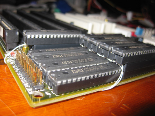

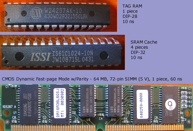

1024 KB double-banked Cache, 10 ns TAG (W24512AK-10), 10 ns cache (8 pieces of IS61C1024-10N)
2-1-1 cache wait state and 0/0 for RAM (33 MHz FSB)

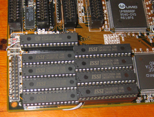

● Biostar MB8433-UUD v3.0 or 3.1
AWARD 4.51PG BIOS, 05/20/96
UMC 8881F (9633-EYT) / 8886BF (9631-FXO) Chipset
Socketed Dallas DS12887+ RTC
Modified to accept 1024K external cache
Modified with a variable voltage regulator
66 MHz FSB system
1024 KB double-banked Cache, 10 ns TAG (W241024AK-10), 10 ns cache (8 pieces of IS61C1024-10N)
3-2-2-2 cache wait state and 2/0 for RAM (66 MHz FSB)

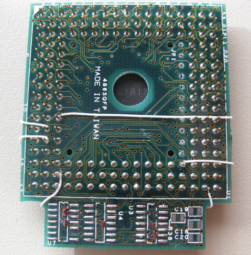

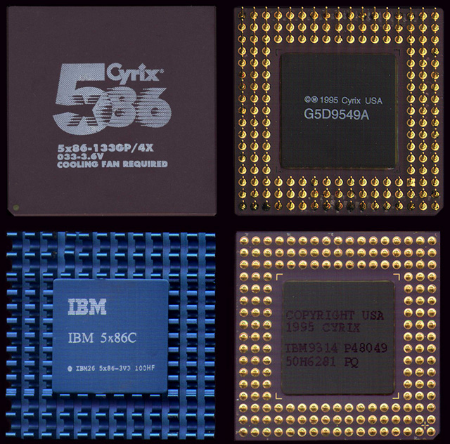

2) CPU
● Cyrix 5x86-133 (4 x 33 MHz FSB)
● IBM 5x86c-133 (2 x 66 MHz FSB)
● RSTK_EN = 1
● BTB_EN = 0 (branch prediction is long-term stable in DOS; set BTB_EN = 1 and LOOP_EN=0 in DOS to improve performance)
● LOOP_EN = 1
● LSSER = 0 (optimal performance is when LSSER = 0)
● USE_WBAK = 1
● WT1 = 1 (for hardware stability)
● BWRT = 1
● LINBRST = 1
● FP_FAST = 1 (must be set to 0 with SiS 496/497 chipset)
● MEM_BYP = 1
● DTE_EN = 1
● IORT = 000

● Samsung 128 MB (2x64) CMOS Dynamic RAM w/Fast Page Mode and Parity, 60ns w/gold contacts K4F640411C-TC60 x 8 pieces per stick
A modified BIOS is attached which allows for setting the L2 cache into write-through mode)
