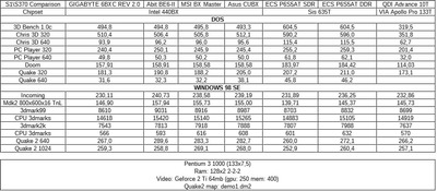

So here are the results:
70.65 KiB
1196 views
What to say.
I'm really undecided which motherboards to keep.
The QDI has a crippled dos performance (there is another topic talking about it here on vogons, apparently no solution, the culprit I suppose it's the Via chipset), while in windows it's not so bad (this motherboard also gave me some issues with the 3dfx v2 sli it's another known problem).
The ECS P6S5AT which is one of the best motherboards thanks to the ddr support, prove that the pentium 3 hardly needs more memory bandwidth as stating during the review of esotical chipset back in time.
About the 440bx chipset there is no a clear winner, but there is a clear looser, the Gigabyte is always a bit slower compared to Abit and MSI, the only advantage is that it has 3 isa slots.
I will try to get a 815 chipset to add it to the comparison.

Nemo1985 wrote on 2021-04-24, 18:45:
So here are the results: photo_2021-04-24_20-35-13.jpg […]
What to say.

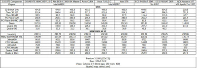

Reply 12 of 12, by Nemo1985
BUMP, after 2 years let's update the comparison.
In a very unsuccessful topic, I briefly explained the difference between Abit ST6 against Asus TUSL2-C, then I decided to take them out from closet again and do the very same testing (with same configuration) as the other motherboards.
Next step if I will be ever able to find them will be to try the Intel i820 and the Apollo pro 266 motherboards.
Here is the updated chart:
