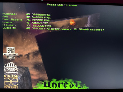

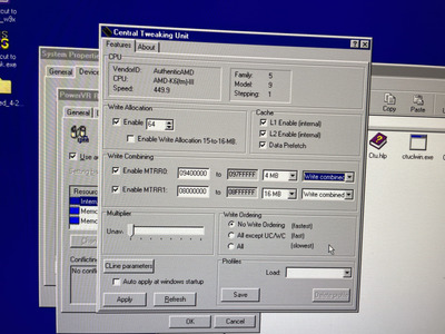

Reply 20 of 41, by Chadti99
Now have write combining enabled for the Voodoo2 and squeezed out more frames! This K6-3 just keeps giving 🤣.

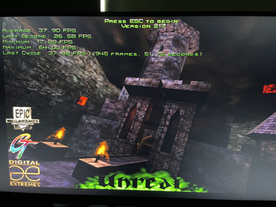

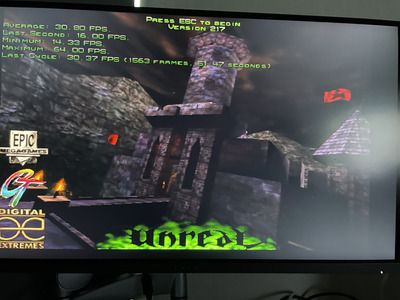

Here’s another comparison before and after the AMD k6 specific optimizations on a Matrox m3D running Unreal. Decent boost!
