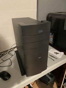

I remember this machine on demo at Radio Shack with the ATI Rage version of Mechwarrior 2 running. Was quite impressive for 96. The machine didn’t look like much else at the time but it had a price tag to match. Recently got ahold of just the tower and I’d like to detail my journey into trying to make this machine work without the original media console or monitor.
Here she is after cleaning her up. And first up, where is the power button 🤣.

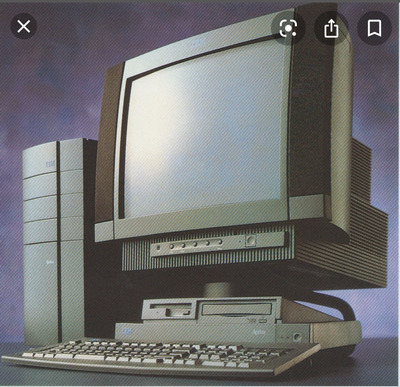

Reply 1 of 35, by Chadti99
This is what the original setup looked like.

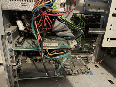

So here’s what the inside looked like, disgusting but not unusual given the age. It’s interesting how IBM was using flat head screws when the rest of the industry was using Phillips.
There are two screws underneath the top front handle you remove and the whole top case pulls forward and off.
Inside we find the dreaded MWave Modem Sound Card combo unit on the bottom. You can also see the “Media Console” ISA control board above.

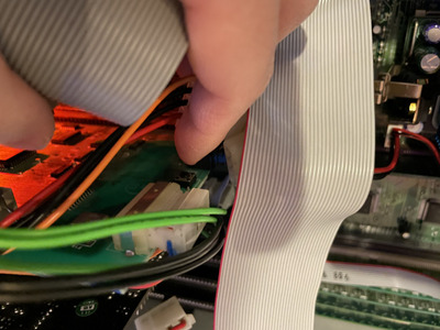

Reply 4 of 35, by Chadti99

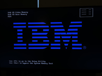

Discovered a way to power it up via IBM documentation!
Just press this microswitch on the ISA media control board. See where my finger is pointing.
Great success!

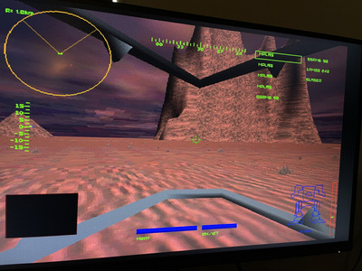

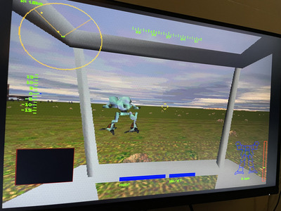

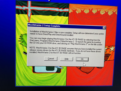

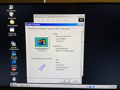

Thank you for not trashing this machine Mr. Biggerstaff. After wiping this drive I installed an SD to IDE adapter and installed Windows 98SE. I was able to harness the power of the onboard ATI Rage 1 to fire up some Mechwarrior 2 Rage Edition! This is exactly what I remembered being demoed at Radio Shack. It was def a step above the original release with its texture mapped graphics but the frame rate, ouch. Still I find it playable with a couple adjustments, namely turning off texture filtering.

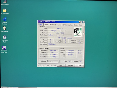

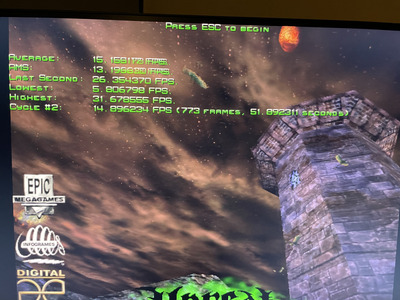

I’ve been testing a Spectra Evergreen K6-2 400Mhz upgrade in this machine and while the results aren’t spectacular it does perform a bit better. This is Unreal running on a Voodoo2 with Glide at 512x384 running Timedemo 1 before and after. High Texture quality setting.
I’ve got a K6-3 on the way, crossing my fingers it will post!

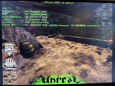

Reply 10 of 35, by Chadti99

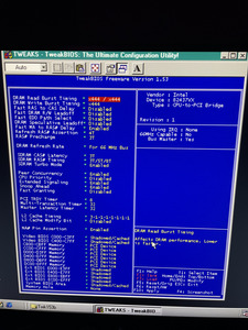

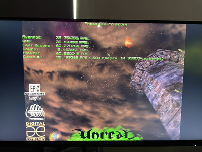

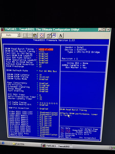

Fired up Tweak Bios and discovered some terrible factory bios settings in place. Was able to optimize a bit and hot damn almost a 50% gain, up 8fps in Unreal . It’s actually borderline playable now.

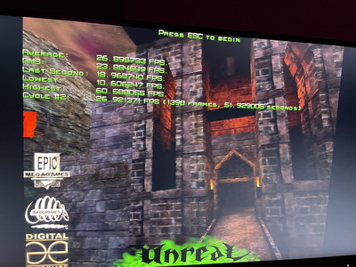

Reply 13 of 35, by Chadti99

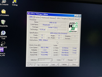

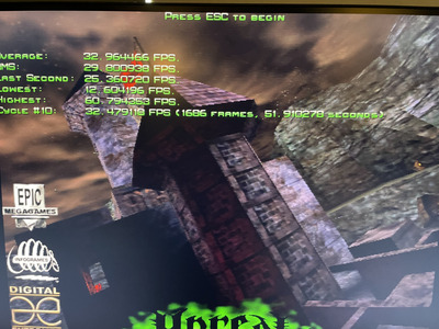

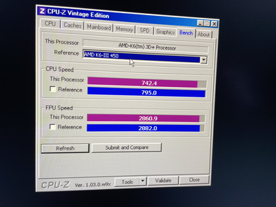

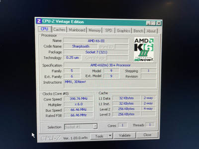

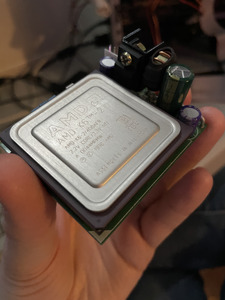

Alrighty, got a K6-3 450Mhz and swapped out the K6-2 on the Spectra Adapter. To my surprise it booted and is working without issue at 66*6=400Mhz. I’m seeing a boost in Unreal from 27fps average to 32.5fps.

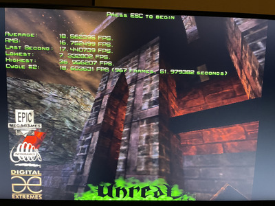

Reply 16 of 35, by Chadti99

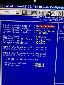

Happy to report I’m running reliably with a 75Mhz FSB. I need a bit more time to be sure but I adjusted the ISA bus divider and wait states to the following using TweakBios and load them at startup via autoexec. Seeing a few more FPS in Unreal!
