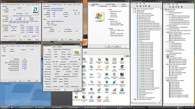

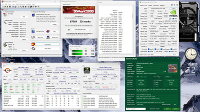

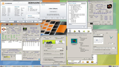

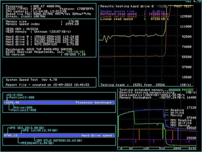

Reply 86 of 89, by DarthSun

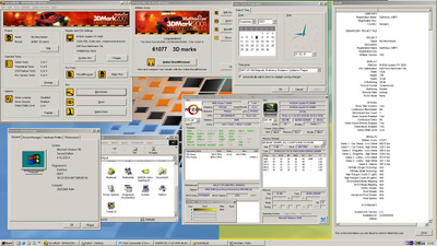

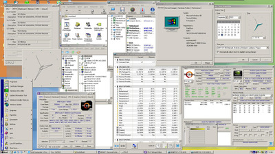

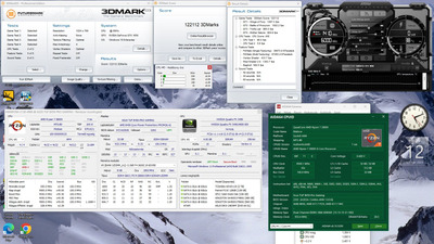

Variations, tests for my madness machines:
R3800X/B450Pro/QFX3500(7900GS)/3DM2001/Win98:
343.61 KiB
254 views
R3800X/B450Pro/QFX3500(7900GS)/SSys/DOS:
114.05 KiB
254 views
R3800X/B450Pro/QFX3500(7900GS)/3DM03/Win98:
360.35 KiB
254 views
R3800X/B450Pro/GTX1650/3DM03/Win11:
412.66 KiB
254 views
R3800X/B450Pro/GTX1650/3DM2000/Win11:
425.96 KiB
254 views

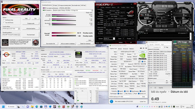

Reply 87 of 89, by DarthSun
Variations, tests for my madness machines, continued:
R3800X/B450Pro/GTX1650/FinalReality:
426.61 KiB
249 views

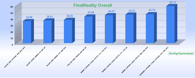

FinalReality scaling in some variations:
89.32 KiB
249 views

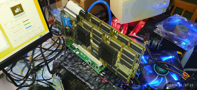

Reply 88 of 89, by mln
DarthSun wrote on 2023-11-23, 04:11:
Variations, tests for my madness machines, continued: R3800X/B450Pro/GTX1650/FinalReality: 225621_r3800x_freal_w11.jpg FinalReal […]
R3800X/B450Pro/Voodoo2SLI:
R3800X/B450Pro/Voodoo2SLI/Win98:
Hi, nice setup. Where did you get the PCI riser you are using for Voodoos?
Reply 89 of 89, by DarthSun
Hi, thanks!
I ordered from: https://es.aliexpress.com/item/10050052605487 … c%21HU%21%21ABS
I bought both the 1 PCI and 2 PCI versions, the former for the sound card, they all work well.
