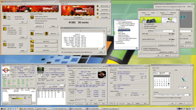

Reply 86 of 89, by DarthSun
Variations, tests for my madness machines:
R3800X/B450Pro/QFX3500(7900GS)/3DM2001/Win98:
343.61 KiB
617 views
R3800X/B450Pro/QFX3500(7900GS)/SSys/DOS:
114.05 KiB
617 views
R3800X/B450Pro/QFX3500(7900GS)/3DM03/Win98:
360.35 KiB
617 views
R3800X/B450Pro/GTX1650/3DM03/Win11:
412.66 KiB
617 views
R3800X/B450Pro/GTX1650/3DM2000/Win11:
425.96 KiB
617 views
