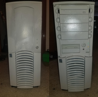

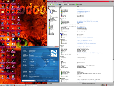

So I decided to put together a Pentium III Rig with a Asus P3C-E and a Tualatin 1.4GHZ P3
Full Specs
Intel Pentium III-S 1.4GHZ Tualatin
Asus P3C-E
512MB PC800 ECC 45ns RDRAM
3DFX Voodoo5 5500
Creative Sound Blaster AWE64 Gold
Creative Sound Blaster Audigy 2 ZS
Kingston 10/100 Ethernet card
Pioneer DVD Burner.
WD Caviar SE 80 GB 7200RPM
500W PC Power and Cooling MKIII
Viewsonic PF790
Chieftec Dragon

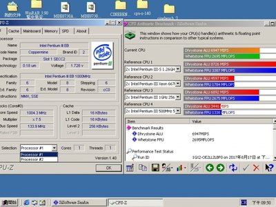

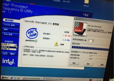

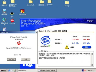

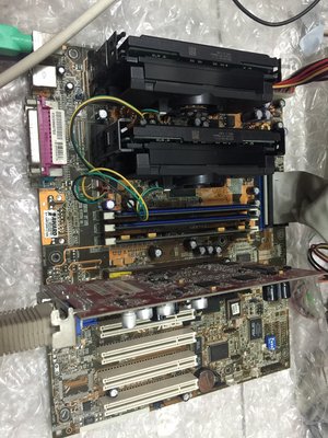

Great! I also have an ASUS P3C-D motherboard with dual P3 1Ghz on it
It’s an i820 board fitted with rambus RDRAM

Wait is that a 3 slot 820 board?
Apparently those were supposed to be very buggy?

Do you mean i820 MTH bug?
That problem comes with i820 board using SDRAM,like asus P3C-2000 or Intel CC820
P3C-D is a single channel RDRAM board,so 3 memory slot is acceptable, unlike i840 chipset features dual channel must use all 4 slot

Not the MTH bug, apparently Intel recalled RDRAM i820 boards with 3 RIMM slots due to interference or noise issues or something like that.
https://www.anandtech.com/show/461/7

i thought it was the first rev of those that had the issue.
