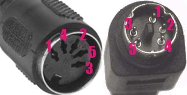

From what I understand, these Creative MIDI cables (which came with some Live! / Audigy cards) can be used with the MIDI in / out ports on a Roland SCC-1.
Can anyone confirm or deny please?

Yeah, maybe so.
Here's Creative's pinout: http://pinouts.ru/Home/minidin_to_din_pinout.shtml
I can test the Roland cables if no one's got the pinout.
Edit: Seems like a lot of people are using Creative cables here: SCC-1 cable

Yep, seems to line up in testing. Made a beautiful illustration for posterity.
    29.49 KiB
    1082 views
    Roland SCC-1 miniDIN MIDI adapter cable pinout

I've been using an SCC-1 cable with an Audigy 2 for years which, as is obvious by now, has worked without issue though mine does not appear to connect the additional two pins anywhere. Means nothing as the Audigy wouldn't use them anyway, only some obscure manufacturer specific stuff ever made use of those.
