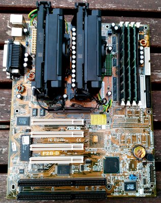

Hello,
yesterday, i finished my latest project: Upgrading a P2B-D to 133MHz.

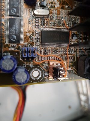

Not only i had to add a jumper, also the clock generator had to be changed.
Maybe due to revisions i only had a ICS9150 on this board, which only supports up to 103 (or 112?) MHz, despite the PDF saying it's 133MHz capable, which it's definitely. So i got my ICS9250s from china and began my work. First attempt was a fail, the board did not post. After checking with my scope and every clock was there, i noticed a loose leg and resoldered the pins with flux and fresh solder. The hotair and flux alone wasn't enough.
After that i had to install the FS3-jumper as described in the tipperlinne-pages (http://tipperlinne.com/p2b-ds150.htm)
Now the board runs rock-solid with 2xP3 1GHz and 133MHz FSB!
I'm using this machine with a Voodoo2SLI-Setup for older games. Installed is Win2K Pro and Win98 (yes, i know, only single cpu).

Reply 2 of 18, by H3nrik V!
But AGP frequency would be 88,7 MHz, right?
Reply 3 of 18, by LeFlash
Yes, but the pci clock stays at 33.3MHz.
Currently, i'm running the system at 1050MHz (140 * 7.5) which gives me 92.4MHz AGP clock - no issues.
For the AGP i'm using a newer cheap GF FX which drives windows and may come handy for newer DX games.

Reply 13 of 18, by pshipkov
The initial post suggest that the clock generators were swapped, but ics9150 is pin incompatible with 9250.
Or do I read it wrong ?
retro bits and bytes | DOS media library
Reply 14 of 18, by LeFlash
It is pincompatible, but has an additional pin for the settings. You have to feed it to a jumper to gain access to the settings.
