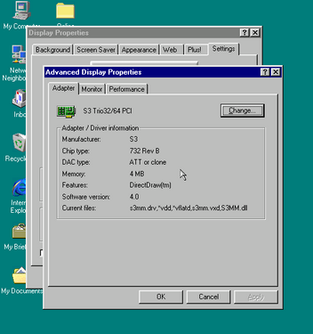

Reply 285 of 440, by ATauenis
CuPid wrote on 2020-04-17, 11:36:
feipoa wrote on 2020-04-17, 10:44:
Is CPU-Z able to display the graphic card information for VLB cards? Everything in the Graphics tab is greyed out.
No, I don't have the smallest idea about how to detect VLB or ISA cards.
Probably they can be detected by reading VideoBIOS. Most of cards displaying their name on startup time, and the name is hardcoded into ROM. So to get the card name a finding of the hardcoded string in the VideoBIOS dump should be enough. However, detecting of VRAM type, clocks, etc seems to be vendor-specific. Or driver-specific. Some drivers are displaying information in system Control Panel, so probably there an standardized API is exists.
15.8 KiB
1505 views
OAK OTI 077 also showed VRAM size for me (on 386 and Microsoft's driver from Win95 CD).
But other drivers does not doing such. Some info like GPU type and amount of VRAM can be retrieved through VESA calls. But this needs an DOS program (like SciTech Display Doctor) or an VxD driver.
2×Soviet ZX-Speccy, 1×MacIIsi, 1×086, 1×286, 2×386DX, 1×386SX, 2×486, 1×P54C, 7×P55C, 6×Slot1, 4×S370, 1×SlotA, 2×S462, ∞×Modern.
