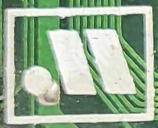

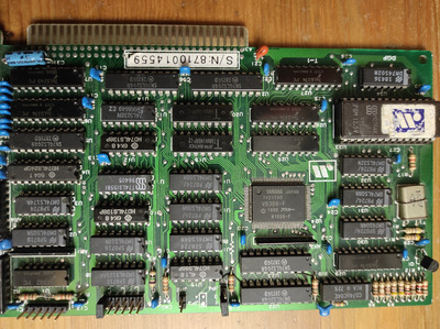

Hi! Recently I get a Hercules card. This is a picture of card:
There are two empty socket. The card works properly. What are they for?
Other question: the block of jumpers. Someone know the meaning of them?

I can't help you much but judging from the naming of the pins in the jumper block I'd say that this card is a dual Hercules/CGA.
M/C should be mono/color, PTR should configure the parallel port (enable/disable/address).
From there on I can only guess that CG might enable/disable CGA and EMU could be emulating the CGA while in Hercules mode (like ATI small wonder does through software)
I have no clue about the dip sockets, except that 2764 should be an EPROM

M/C = MonoChrome
P = ?
TR = ?
CG = CGA
EMU = (Hercules?) EMUlation
It's not a Hercules card, it is a Hercules Emulator

The sockets are for a BIOS chip and Octal latch. Those would add CGA capability if not included in the motherboard iirc.
The jumpers are for setting the video Mono/CGA, LPT port (LPT1, 2, 3 or 4) and video emulation for MDA, Mono CGA, Color CGA.

EXT C G = EXTernal Character Generator
You can install there a 2764 ROM chip with some font, eg. one with national characters.

Anywhere you can buy electronic components. The useful options depend on your location. The chip you need is named "74LS374". The card already says "LS374" on the silkscreen, and the 74 was supposed to be obvious to anyone into digital electronics. There are more modern variants of this chip that should be 100% compatible, like the "74HCT374". The "T" is important for full compatibility, but most likely, any "74...374" chip you can obtain will do.
I suppose the CG jumper is not about "CGA" though, as other posters guessed, but is used to switch between the internal character set and the external character generator ROM.
I think the same. The card's IC likely contains the standard CP437 code page already.
The EPROM is meant to hold a copy of a foreign/national character set.
Say, Greek or French. For other languages (German etc) the ordinary CP437 may also suffice.

No need to remove the ROM - as others already stated, there should be a jumper to select internal/external CG.

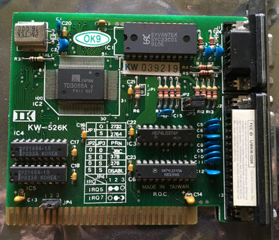

Here is one MDA card with a soldered ROM, a Kouwell KW-526K. The other with a socketed ROM one is in my Luggable.

I also have a card with that TD3088 controller chip. My card also has a ROM soldered on it. I am very confident this card needs the ROM to operate properly. Cards without a ROM only work because a part of the controller chip (which will not be a TD3088) contains a copy what our cards have in the external ROM. Maybe we just misunderstood what you were trying to do. It doesn't seem to make sense to operate a card like that Kouwell KW-526K without any ROM at all. On the other hand, swapping the ROMs between two cards might make sense to find out if their ROM memory layout is compatible, or if they have different fonts and you prefer one font over another. I'd guess most CGA/MDA cards just have a (unlicensed?) copy of the original IBM MDA/CGA font ROM, though.

That TD3088A card seems to support 2732 ROM as well, ie. 4 KB, ie. not enough for the entire MDA/CGA set of 8x14+8x8thin+8x8thick.
Must be 8x14 only.
