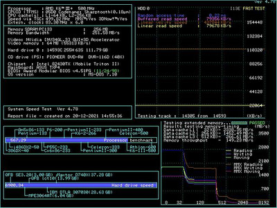

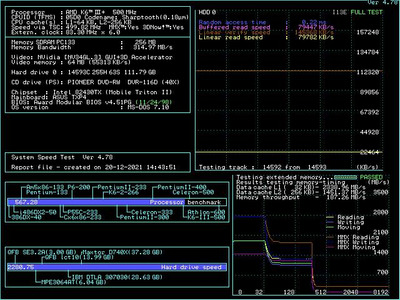

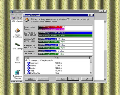

You'll want to test your memory bandwidth with the motherboard's cache enabled and disabled once you have the K6-2+. With my TXP4 and a K6-2+ modified into a K6-3+ the memory bandwidth is significantly better with the motherboard's cache disabled.
Edit: Speedsys also shows that the system has better performance with the motherboard's cache disabled when combined with a K6-3+

Repo Man11 wrote on 2022-07-28, 17:07:
^yes indeed!
Socket 5/7 systems can go either way, but most super socket 7 systems are better with it enabled.

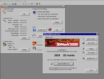

Reply 38 of 53, by haker120

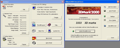

Benchmark of Radeon Mobility 7500.

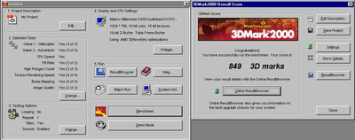

And Matrox G450. 😁
Reply 39 of 53, by Sphere478
You got the 7500 working on the socket 7? Or this is on super socket 7?
